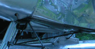

PostPosted: Sat Dec 12, 2009 6:02 am    Post subject: water heat for the cockpit Reply with quote
Larry
I belly mounted a VW rad, hinged at the front so I can vary the outlet in
flight. Made two inlets into the cabin through the floor and voila. Pic
attached.
Carl
