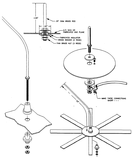

PostPosted: Mon Nov 30, 2009 12:00 pm    Post subject: ICOM 210 antenna suggestion Reply with quote
At 09:15 AM 11/30/2009, you wrote:
(1) See any aged member of your local Amateur Radio club for the formula and shape of a ¼-wave vertical,
(2) Invite him to see your project and he might just make you one, and
(3) Stick it on top for better coverage of Ground Control at some airports.
All of which is dead-on accurate. I've constructed several
DIY comm antennas with the idea of publishing a how-to article.
Haven't produced a recipe-for-success that I'm ready to
offer.
The EASY part about building an antenna is cutting off a
chunk of material the optimal length to become an efficient
antenna. The not-so-easy part is mounting the antenna
to the airplane such that it doesn't twist in the hole,
maintains low resistance contact with coax center conductor,
good connection with airframe as a grounding surface,
is fabricated in a manner that will withstand years
of inattention and hours of buffeting in hurricane force winds.
[img]cid:.0[/img]
Here's a snapshot from the 'Connection (Figure 13-Cool that
illustrates some of the $low$ antennas that were popular
about the same time the Narco "coffegrinder" radio was
a radio of choice in SE light aircraft.
Threaded rods, ceramic feed-through insulators and
ordinary PIDG terminals did the job for us then . . .
sorta. Cessna used to install similar antennas in
production. If you don't mind replacing the occasional
broken rod, refurbishing corroded terminations, suffering
leaks in the skin, etc. etc. This approach will perform
ELECTRICALLY as well as anything you can buy today.
If any of the List members have devised a means by which
more robust antennas have been crafted, can you share it
with us? In the mean time, I'll see about cleaning up
some ideas I've been exploring and getting them published.
[img]cid:7.1.0.9.0.20091130191005.01d9e1d8(at)aeroelectric.com.1[/img]
