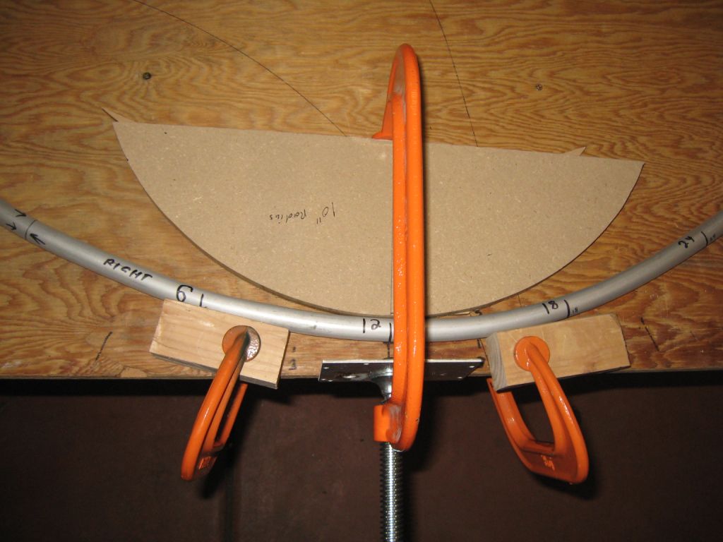

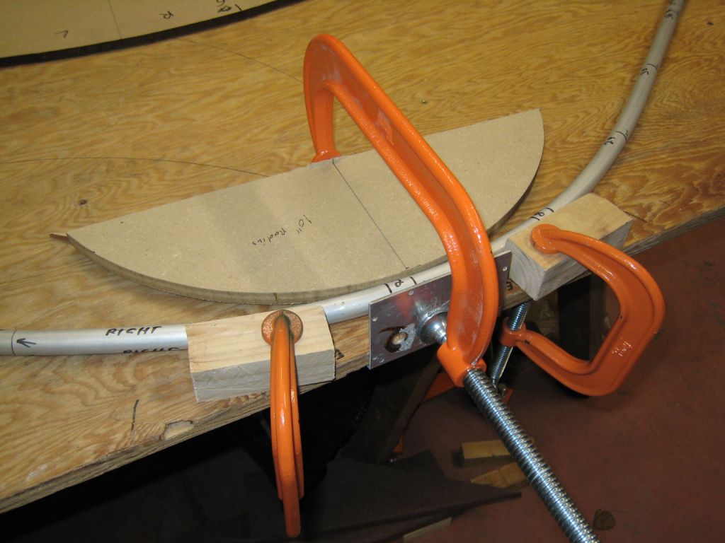

PostPosted: Mon Nov 23, 2009 5:53 pm    Post subject: How to bend hoops? Reply with quote
When bending the hoops I found it easier to work from the center out (both
ways). Also the same bending jigs can open a bend up if you go too far.
Don't trim the tubes to length until all done - the extra length gives you a
handle and more leverage.
You need different radii along the tube so you need form blocks with
different radii.
I've attached a couple of photos.
-- Craig
