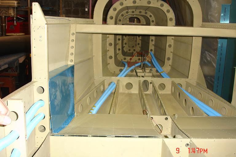

This is what I am doing this weekend. (chapter 33-5). I visited Lowe's electrical section and purchased 100ft of flexible PVC 3/4" diameter.contractor conduit for $31.00. It's light weight and UL listed. And I tried to light the stuff with a BIC lighter to test it resistance to fire. As soon as I removed the flame the fire went out. test passed. The picture is only partly completed I have to add A-dell clamps on each of the conduits.
Flexible conduit in the fuselage

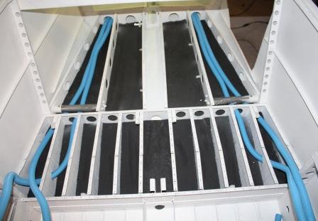

Blue smurf conduit from homo depot. I ran mine sideways through the ribs so it wouldn't ruin the structural integrity of the rear wing spar bulkhead.
 Filesize:  68.16 KB
 Viewed:  8264 Time(s)
