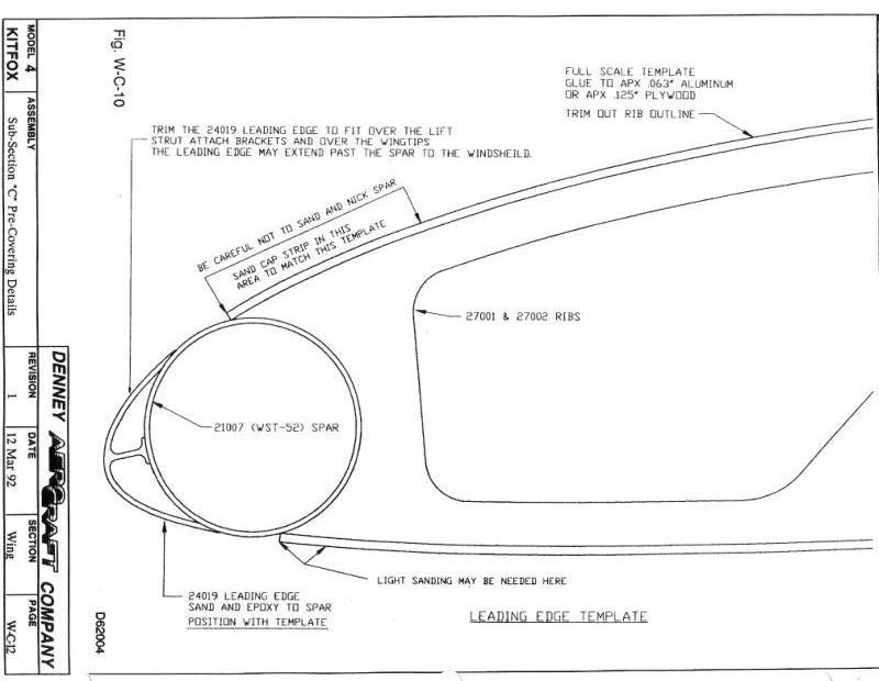

Ken, here's a copy of the leading edge template for a model IV rib.
 Filesize:  50.99 KB
 Viewed:  36237 Time(s)

Would this leading edge mod work on a Model II as well.
Ken

I don't see why it wouldn't work, Ken, as all Kitfoxes use the tubular front
spar. However, the shape of the wing on the 3 is much different than the 4
so I don't know if it would provide any more performance.

Buddy put it on his Model I when he rebuilt it last year. He bought it as a basket case, so we never flew it without them, but I will tell you the cruise on it is better than on the Model II at about the same weights. Climb is better also.
