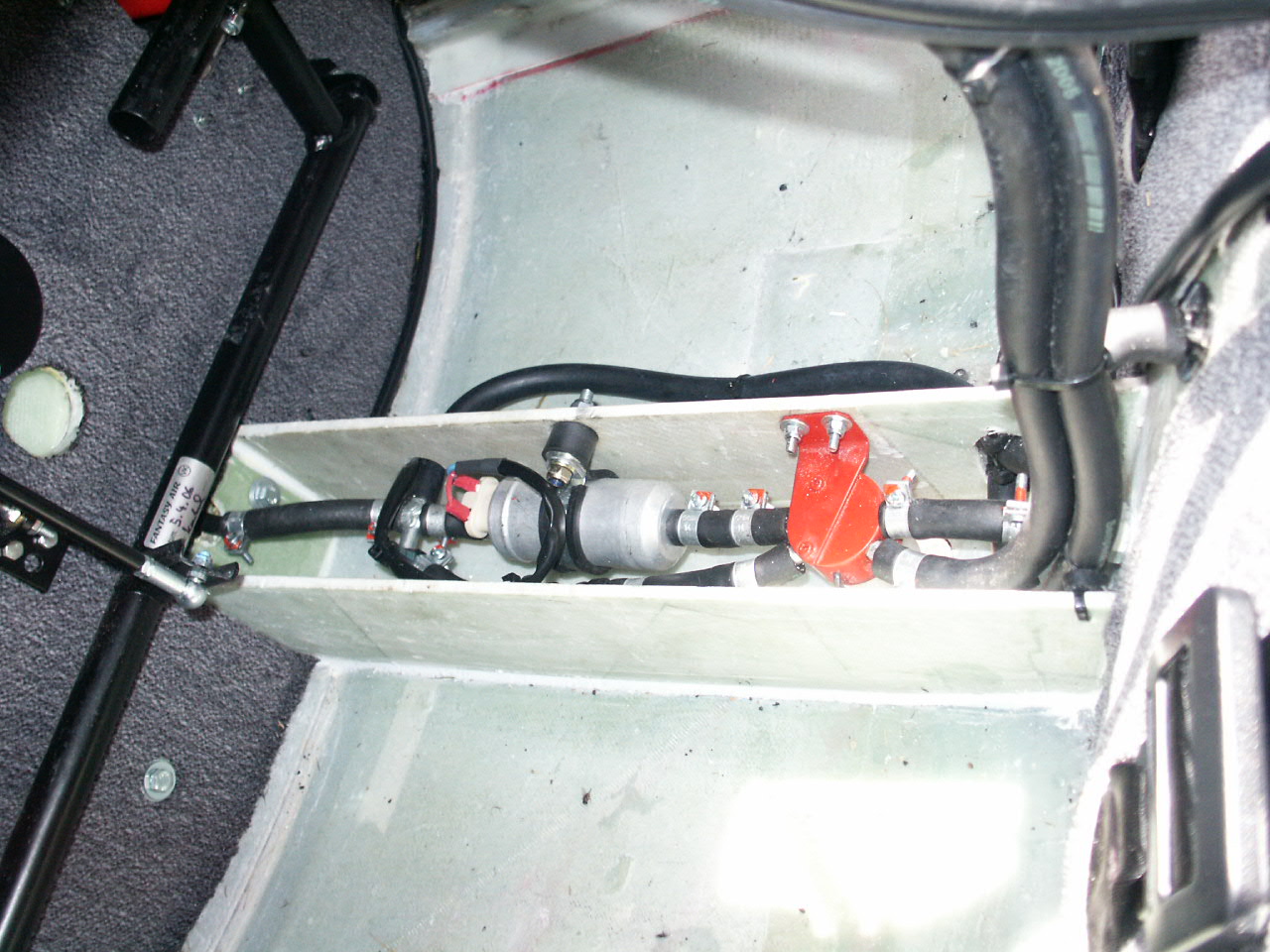

The factory installed the electric fuel pump in the central tunnel below the floor boards in the cabin. The silver colored cylindrical item in the attached photo is the factory supplied fuel pump. Note that this photo is from an Allegro that also has the optional fuel tanks in the wing which is the reason for the extra hoses, compared to those Allegros with only the belly tank. You will notice that this installation has the electric fuel pump in series with the mechanical pump instead of in parallel.

Obviously, the series installation works and the flow from the electric pump does go through the mechanical pump when the engine is not running. However, my preference is to install the auxiliary pump in parallel. FYI, the mechanical pump is a simple diaphragm pump that is activated by a cam lobe on the propeller shaft. Inspection of this cam lobe and pump is an item on the annual inspection list and is very easy to do.
If you notice in the photo there is a line running along side of the electric fuel pump. This line contains a check valve I think. I no longer own an Allegro so I'm going by memory only. If the Facet pump is small enough and has a built in check valve to prevent back flow, then there might be room in this under-floor tunnel to install it in parallel with two fuel lines penetrating the firewall.
