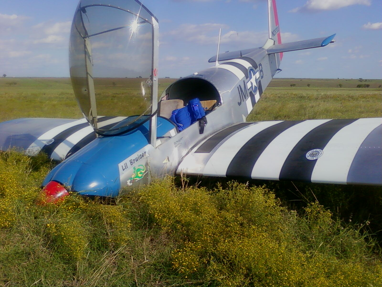

I was the pilot flying Jay's airplane. I was helping Jay get the testing under way. I had a detailed test plan for the flight on my clip board and I was wearing a parachute. To save time and typing to each one individually, I am including a portion of the FAA report I wrote about the incident:
"A climb was made to 3500 MSL outside of the Mode C vail. The stall series was completed and the aircraft was in level flight when the engine started to surge several times. A turn was immediately made to JWY as the engine returned to normal. About a minute later, the surges returned. At that point, tanks were switched, the other coil and fuel pump were selected. Shortly thereafter, the engine surged several times again and quit.
A plowed field was picked as the best landing spot. Attempts were made to re-start the engine 3 times with no joy. At 2500 MSL, it was determined that the plowed field could not be reached so the landing spot was switched to a pasture. At about 500 AGL, it was noted that the pasture was terraced in the east-west direction, with the plane on a northerly heading. The decision was made to maintain the northerly heading and not make a sharp turn to the east as there was too much danger of a stall/spin condition. At about 5 AGL, the plane was slowed to stall speed and allowed to settle on the rising terraces.
The aircraft touched down on the upslope of a terrace and re-launched into the air. The re-launch took the aircraft another 10 feet further before settling down. Estimated touchdown speed was about 40 MPH.IAS. The touchdown point was on another upslope. There was no more elevator authority at this speed to keep the nose wheel off the ground at that speed. The nose wheel caught the upslope berm and bent back causing the nose to fall to the ground.
Damage sustained was minor. The cowling sheet metal was bent as was the sheet metal and rudder pedals where the nose gear pushed into the fuselage. The left wing inertia of coming to a stop pulled the rear attach fitting bolt through the attach fitting. The spinner sustained some damage being dragged through the dirt on the under side, but the propeller did not touch the ground. The ground impact was mild enough to not trigger the ELT.
Upon coming to a stop, all power and switches were verified off and the canopy was released. The aircraft was exited and a safe distance was maintained. A walk around of the aircraft was performed and it was determined that no fuel was leaking."
If the nose wheel had not caught on the berm, there would have been no damage to the aircraft. My primary flight training kicked in automatically and I made a deliberate effort to not over control or over maneuver the airplane. My recent glider rating was a BIG BIG help. Once I stopped trying to restart, my brain shifted into glider mode and that removed tons of stress. It became just another glider ride.
Recommendation to you for first flights/ Phase I testing: If you don't get a glider rating, get enough time in a glider so that landing without an engine is a not new to you.
Nuf said.
Bob

PostPosted: Tue Oct 27, 2009 7:43 pm    Post subject: Jay Bannister - OK ? Reply with quote
Bob, any early indications of what happened to the engine? Has fuel flow or ignition been checked yet?

PostPosted: Wed Oct 28, 2009 3:21 am    Post subject: Re: Jay Bannister - OK ? Reply with quote
We have to wait for the insurance company to look at the airplane before we tear it apart.
