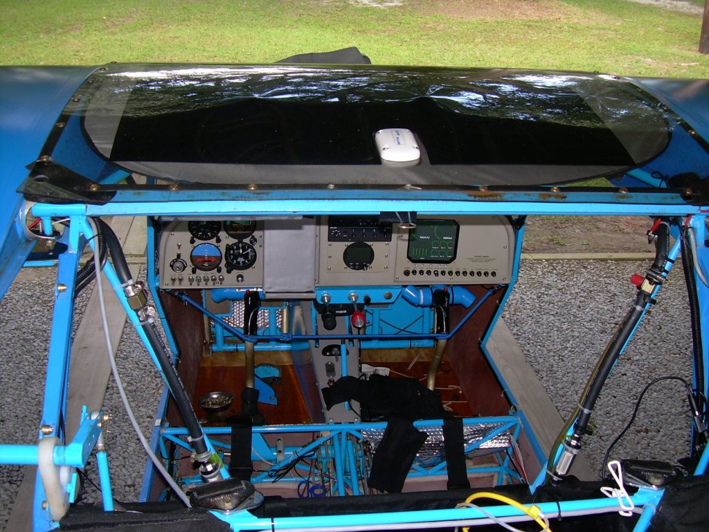

On Oct 26, 2009, at 2:04 PM, FlyboyTR wrote:
My fuel configuration has remained virtually unchanged from the way
is was when I purchased the Vixen from the builder. Yep...vent
line from top of header tank to the top of the right wing tank. My
fuel caps have the vent tube that is welded to the top of the cap.
They both face forward and I blow through them each time I add
fuel. They have also been checked with a pipe cleaner to ensure
something wasn't hiding inside!

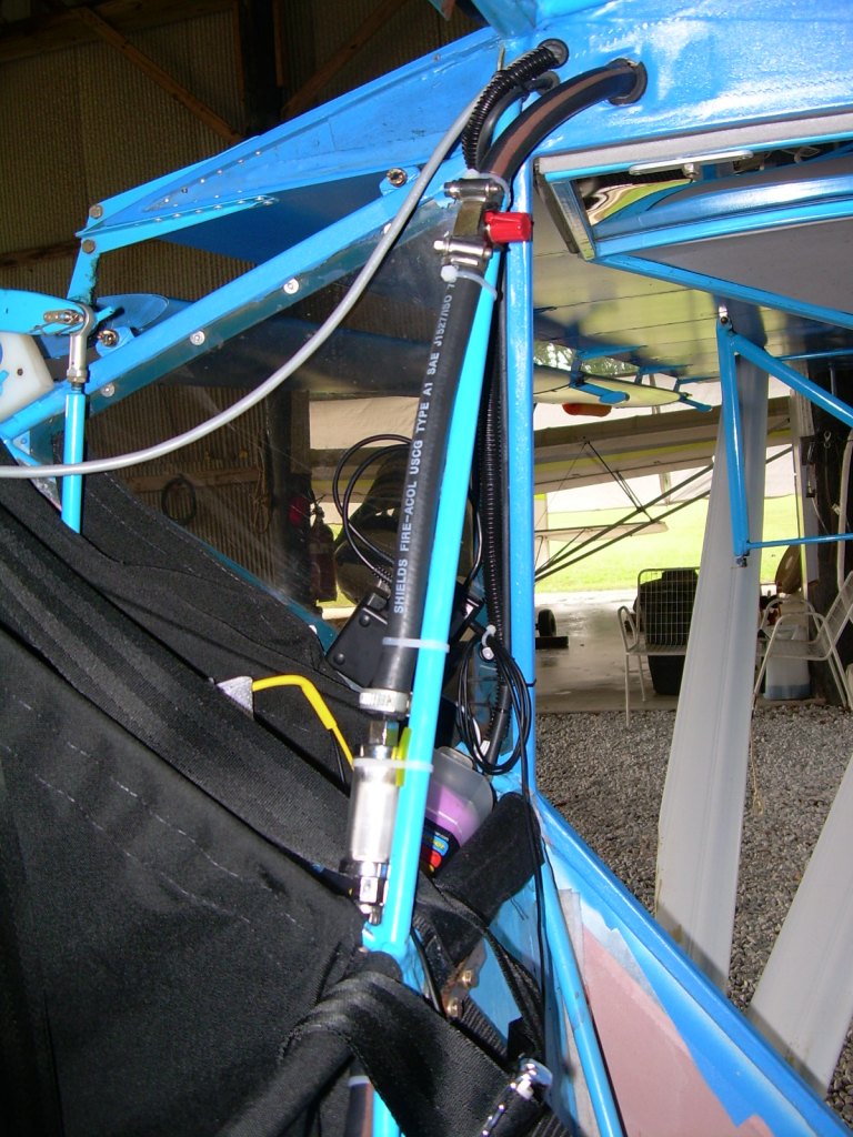

My system has 4 filters. One on each fuel line from the wing tanks
to the header tank, a larger sintered type (aluminum housing)
filter just after the fuel leaves the header tank and the same
filter again just before the fuel enters the engine driven fuel
pump. The only changes I have made were replacing the in-line fuel
valves with a "higher" flow valve than was originally installed.
In September, during my conditional inspection, I replaced the
filter elements (which flowed freely).
Duane,...my Purolator filters are located rather high. ...Hadn't
thought about that. After purchasing the plane 07/06, I replaced
all the flexible fuel line. I did move the valves and filters
higher (closer to the tank) to help protect them. Just
guessing...the bottom of each filter is probably about 6" below the
wing tank.

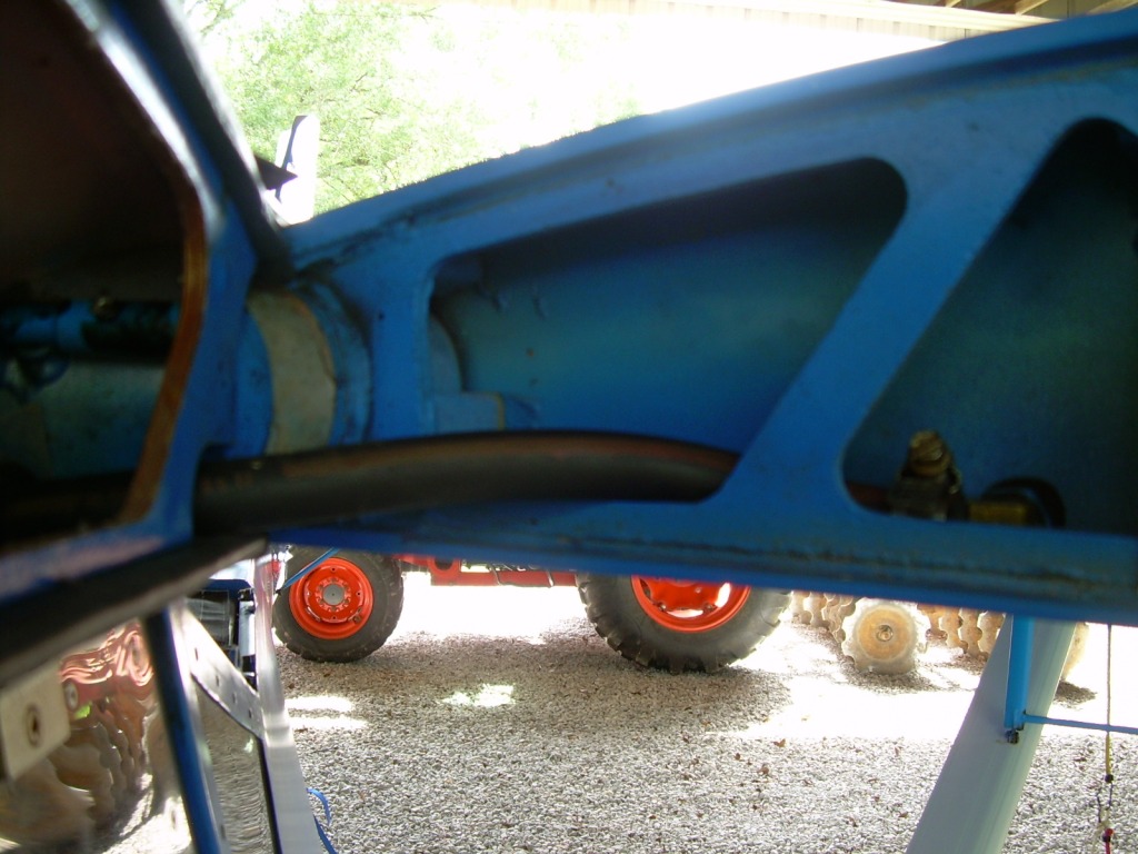

Today I noted that my fuel lines (from the tanks to the header) do
have some horizontal component to them (behind the seat)...not
completely flat or uphill. I can shorten those lines to make the
flow as vertical as possible.
Odd thing is...the fuel problem is not consistent. It does seem to
occur more frequently when I fill the fuel tanks "completely"
up...but not always. It can be one tank...then the other...that
has the flow problem.
I don't remember checking the finger strainers in the tank. I will
check those, just in case!
Travis Smile

Lynn,
My glass filters are the ones with the metal fittings on each end (not the plastic ones). You're right...there is a big difference in quality. My fuel flow is correct and flows to the "bowl", through the filter, then out the bottom.
A six inch difference in filter height isn't much...but when considering the limited head pressure, I'm sure 6" makes a considerable difference.
At present I'm going to do four things (I'll do all of this while everything is torn apart for the new alternator coupling) Sad :
1, Lower the filters as low as safely possible and still visible,
2, Shorten the fuel lines to remove as much horizontal component as possible,
3, Replace the fuel cap gaskets (not leaking...but are hard,
4, Inspect the finger strainers.
I really like having a visual check of the fuel flow in the glass filters. Without that, if you had a fuel issue, you wouldn't have any idea which side was the problem...or where to start troubleshooting.
Fingerstrainers.... does the strainer come out with the fitting? I have seen strainers that were integral to the tank and non-removable.
Again, thanks to everyone for all the help and suggestions. I really look forward to moving past this problem.
Travis Smile Smile

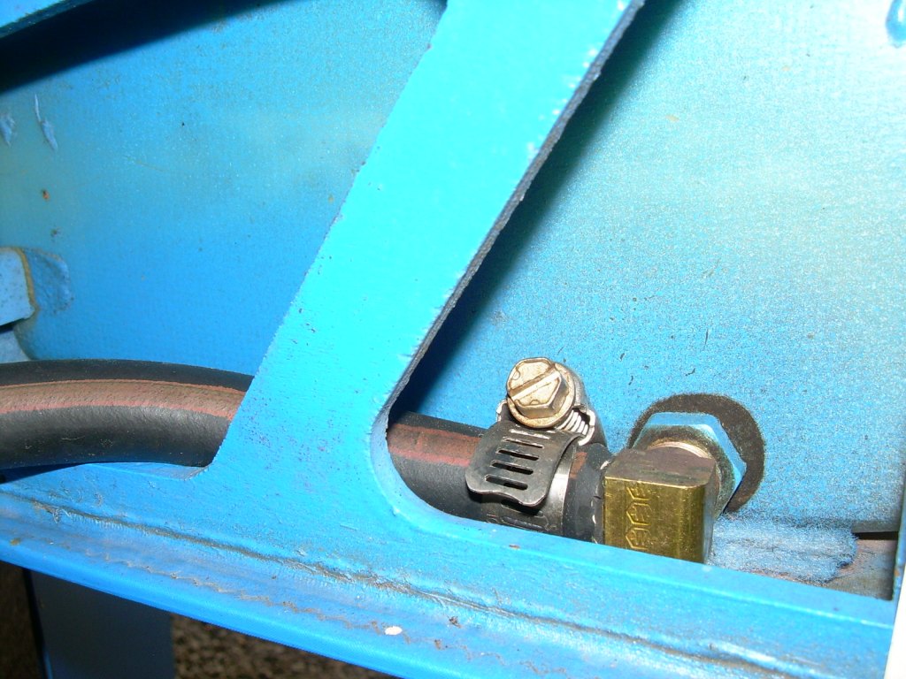

My tanks have the finger strainers screwed right into the tank
itself....no step-down bushing is there on mine. The strainer sleeves
will come out with the fitting, if they're like mine. If yours has
two brass "fittings" at that location, it is because there is a brass
bushing that is meant to remain in the tank, and the finger strainer
itself. Removing the smaller of the two fittings and you'll have the
entire finger strainer in your hand. I removed mine a couple weeks
ago and found nothing trapped on it after three years of flying.

Oops, I goofed! My finger strainer is the largest of the two fittings
at the finger strainer location....the smallest is the fuel fitting
itself. (I forgot about the fuel line fitting) The largest is the
strainer, and there is no "bushing" on mine. Sorry 'bout that.

OK, I have made changes to the fuel filter locations and reduced the extra hose to allow for a more direct flow to the header tank.
I also installed an on/off valve in the header tank vent line. If by chance the system air-locks...at least now I can close the vent line and force the system to pull from the tanks, rather than sucking air.
I folded the wing to check the finger strainers. I was unable to remove the 90 fitting (see picture). To do do would mean I would have to cut the fabric in the bottom of the wing. Any suggestions? does this look like the KF setup?
Left wing tank: The fuel line travels upwards from tank outlet, over the end rib and then down. Comments?
 Filesize:  209.04 KB
 Viewed:  23058 Time(s)

90 Degee fitting. Unable to remove without cutting wing fabric.
 Filesize:  196.58 KB

View from rear. Both fuel supply lines, location of filters, cut-off valves and valve on vent line.
 Filesize:  220.66 KB
Left wing tank supply. Filter was previously located directly under the fuel valve (red knob). Move to lowest possible location.
 Filesize:  220.33 KB

PostPosted: Sat Oct 31, 2009 1:31 pm    Post subject: Fuel Flow Problems, Again! (Vixen, Series-5) Reply with quote
I would use a Dremel tool and cut off the "bent" part of the fitting,
remove the fitting and replace it with a straight fitting if at all
possible.
It looks to me like the tank outlet in your number "210" photo is
several inches more forward than my Model IV, but maybe that's
standard for the Vixen. The IV instructions had me cutting a notch in
the rib (my tank outlet is at the very rear of the tank) so that a
straight fitting could be screwed straight into the finger strainer
fitting. Looks like they went with a center-feed tank in those models.
Some folks just don't think far enough ahead when they are building,
as to allow for servicing the plane down the road, and your builder
was probably one of those. Maybe the instructions called for a 90-
degree fitting....if so, then the instructions didn't think far
enough ahead in my sometimes not very humble opinion. Ok, I'll quit
griping. How about cutting the 90-degree portion of the fitting off
*just* a little bit so you can rotate the fitting out of the finger
strainer. Maybe you just need to depress the fabric a little
bit....possibly laying a length of thin plastic under the fitting
where it would rub on the fabric every time it rotated towards the
bottom as you remove it.
When I suggested cutting off some of the "bent" portion of the
fitting, I recall that some of these fittings have more than
necessary length, and can be shortened. I would look for the "bulb-
ended" fittings rather than the "barbed" fittings. In my experience,
the bulb-ended are shorter than the barb-ended fittings, and will
allow for removal of the hose without totally destroying the hose.
I can't understand why your system would suck air....it pulls from
the bottom (or very near the bottom) of the header tank, doesn't it?
Lynn Matteson
Jabiru 2200, #2062, 804.3 hrs
Countdown to 1000 hrs--196 to go
Sensenich 62"x46" Wood prop
Rotec TBI-40 injection
Status: flying (and learning)
sucking air.
