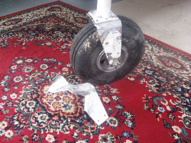

During high speed taxi runs at around 50knots lifted the nose wheel off and the mains maybe yes or no [ spectators not sure either] on lowering via elevator input [in hind site should have just pulled more elevator nose up for a smoother transition] the nose wheel come down and bumped back up[the runway has a couple of bumps as well] and on going down again the fork bent side ways as it hit the runway [due to a small right rudder input the wheel would have been pointing to the right].Basically the fork just collapsed/folded to the right jammed the nose wheel thus causing a prop strike,bent axle,firewall,and nose wheel strut. So it's back to the hangar for repairs and I'll look at strengthening the fork so it will resist the side loads better. Sitting here with a gnawing feeling in the pit of my stomach and trying to asses what went wrong. Cheers T87 Sad

I have the latest fork with the doubler installed, but it still folded side ways.I'd done about 3hrs of taxi runs prior two days at around the 40 knot mark and wanted to get near the lift-off envelope to see it would behave.We also did a couple of runs with two up at 45-50 knots and we lifted/lightened [not of the ground] the nose with no problems again to see how it would perform with the extra weight.It was just fine.On the day with two on board there was a 10knot cross wind and it weather cocked in a very predicable way and easy to handle.Just prior to the incident it had just passed the final inspection as well. Got the plane now back home and will start the repairs.In Hind site I'd just keep the stick back and use engine power to settle it down just like in a landing. ASAP Cheers Alan

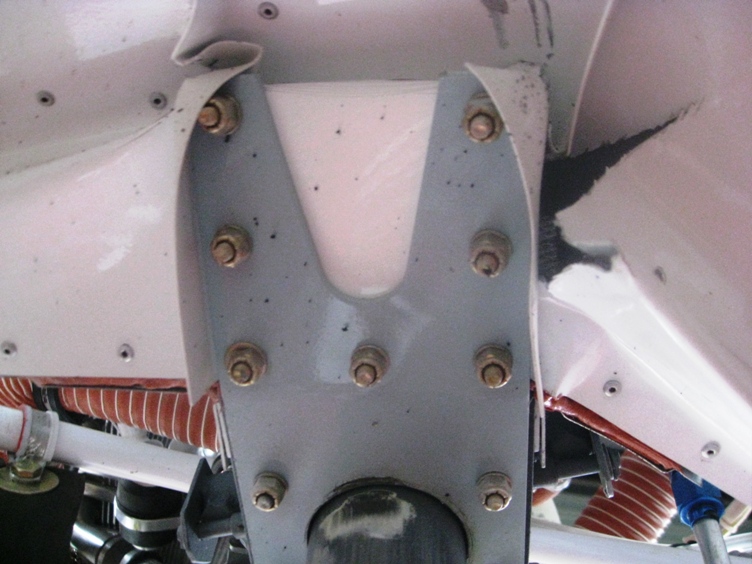

PostPosted: Sat Oct 24, 2009 7:25 pm    Post subject: Re: Nose wheel fork failure Reply with quote
Don't have any pics of the collapsed fork as we straightened so we could move the aircraft

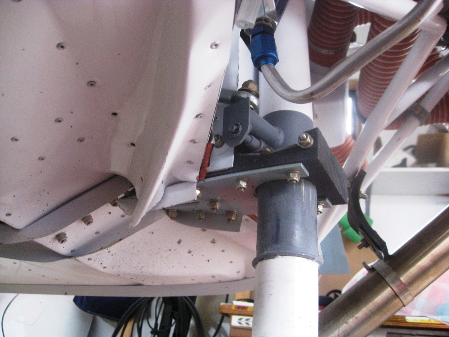

PostPosted: Sat Oct 24, 2009 7:28 pm    Post subject: Re: Nose wheel fork failure Reply with quote
And this

Does your fork have the doubler (6G1-5 on an XL)? Any photos?

PostPosted: Sat Oct 24, 2009 10:36 pm    Post subject: Nose wheel fork failure Reply with quote
On the photo of the front gear is that extra stepped rod resting in the V
block (below the main cross tube that links to the rudder pedals) your own
addition or something from the factory? I'm guessing you had to add it when
the cross tube on the factory part didn't reach the V because to the stop
plate on the top of the gear. I think I can also see an extra shim fitted
into the V of the black nylon part.
-- Craig
Thruster87
Joined: 16 Apr 2008
Posts: 193
Location: Australia
PostPosted: Sun Oct 25, 2009 1:18 am    Post subject: Re: Nose wheel fork failure Reply with quote
-- Craig
It was a mod I did to allow the nose wheel to move more freely.It has a stainless steel rod with phosphor bronze bushes resting on a crom-moly plate bolted thru the bearing material for the V.It really made the rudder pedals free up and smooth to operate and self centering the same as the original.As you can see it stayed intact even thro the nose leg tube bent. Cheers

first point of failure to some other component. From the looks of
those photos, the nose gear must have come down very hard and it
wouldn't have helped much if the fork had stayed intact. That fork
absorbed a lot of energy before it failed. It won't do much good to
make the fork indestructible if it causes the strut to shear off and
you plant the nose on the runway at 40 mph.
At 50 mph and full throttle, that elevator has a whole lot of
authority, you have to use a light hand on it. At full throttle, once
that nosewheel comes off, that airplane wants to get airborne in a
hurry. Be ready to chop the throttle and let it settle in.
