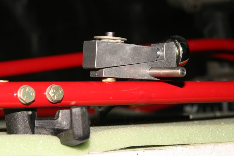

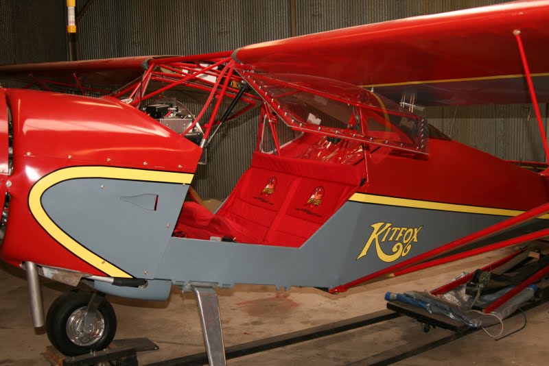

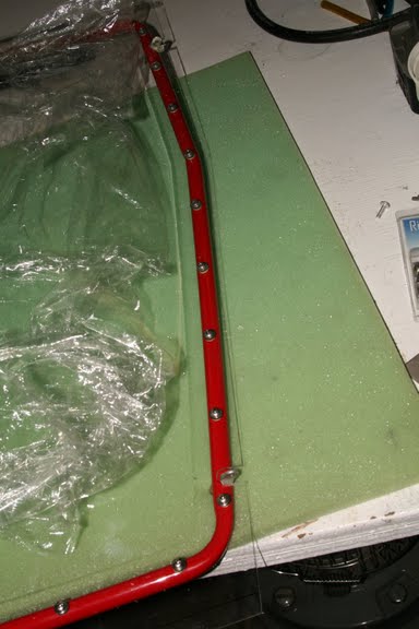

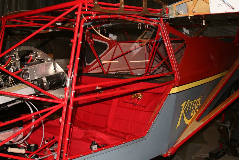

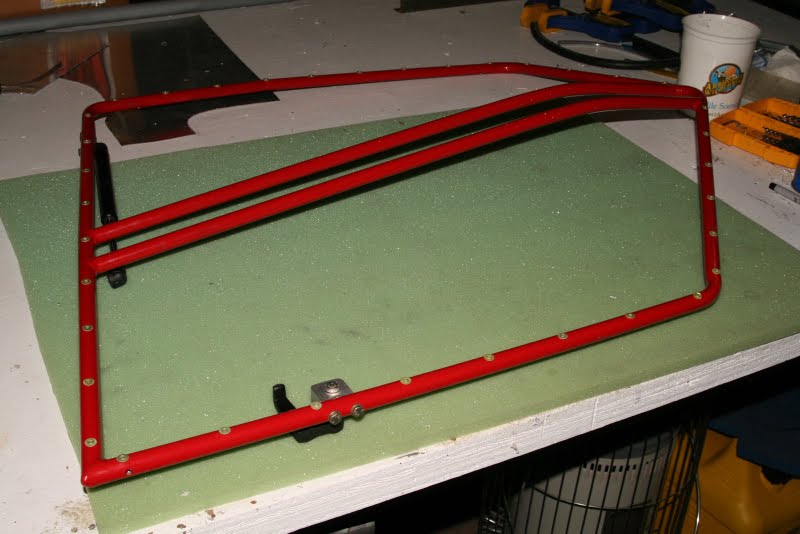

We finished up the doors and windows recently and decided to go with rivnuts. worked out extremely well. We used 8-32's. They work great on the round tube. The round tube helps from the stand point of once the rivnut conforms to the inside of the tube they Can't ever turn out. heres some pics...(sry, I think they keep posting in backwards order)
