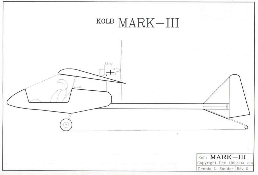

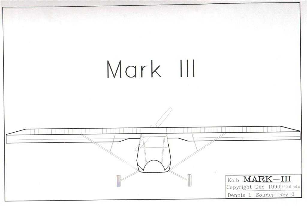

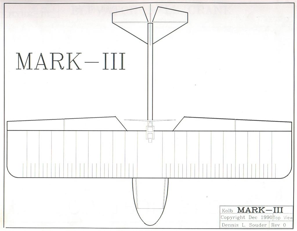

I'm going to attempt to build an rc scale model of my Mark IIIc. Could someone with a set of plans possibly take a couple of photos for me? I'm mainly interested in the airfoil shape and cage design.
Any help is appreciated.

The plans do not show the cage. And the airfoil is as simple as these drawings show it - hope these help -

For the airfoil, take a look at the NACA 66. If that it isn't it (it's LE radius may be a bit larger), it's very close.

Thanks! The 3view helps a ton. I'd still welcome any pics or drawings that might make the build easier.
Has anyone heard of someone doing this before?
Keath T
