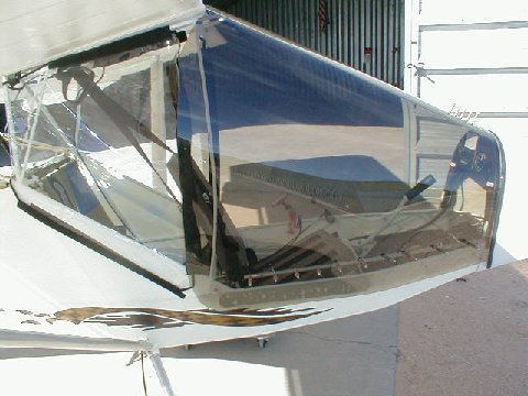

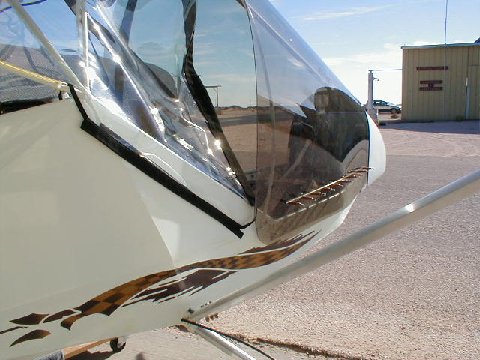

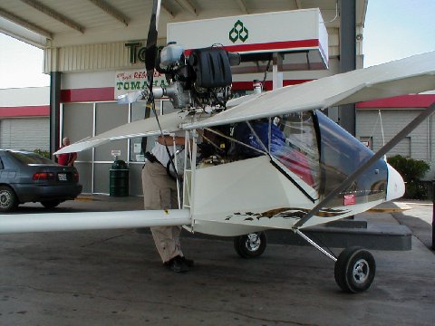

Hi Eric,
Here some pictures of the full enclosure installed on my FireStar II. The rear clear cover is not installed completely so you can see it's not stretched. It protects you from the elements and keeps you warmer in the winter. The down side is your adding more weight, need to undo the Velcro on of the rear cover to pull start the engine and slows you down a little. Yes you can still shoe horn a grown up in the jump seat. I ordered my enclosure kit from Kolb. I fly with the full enclosure in the winter and remove the rear cover in the summer.
Hope this helps,
Will Uribe
El Paso, TX
FireStar II N4GU
Will's FireStar
Kolb FireStar II

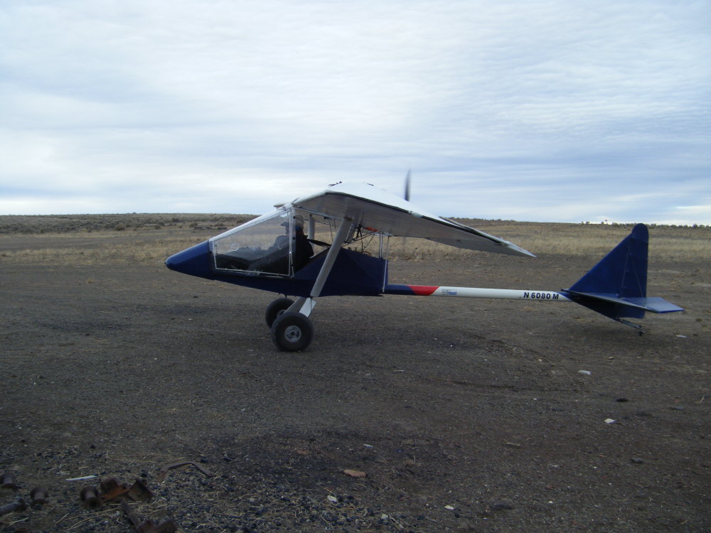

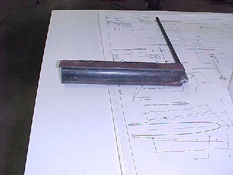

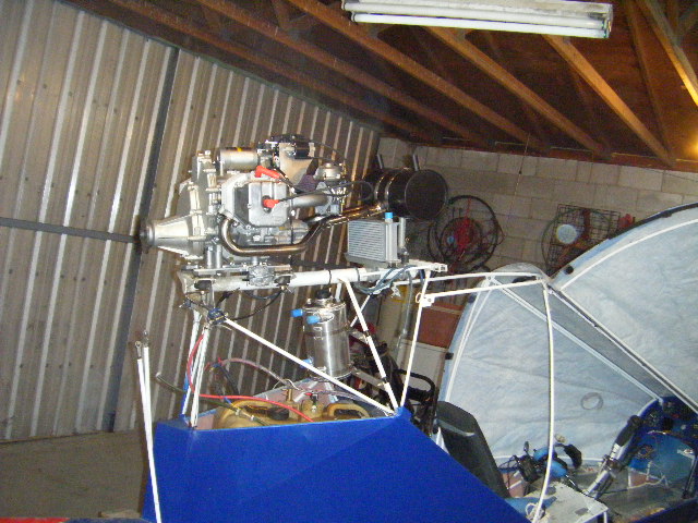

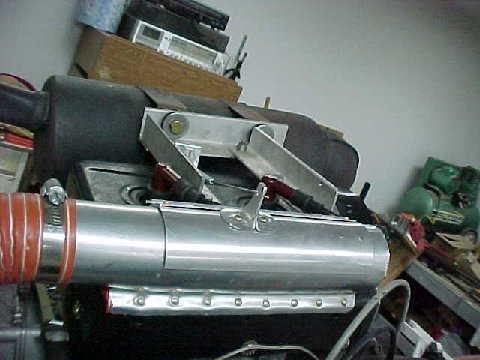

lcottrell
Joined: 29 May 2006
Posts: 1494
Location: Jordan Valley, Or
PostPosted: Mon Oct 05, 2009 5:05 pm    Post subject: Full Enclosure Reply with quote

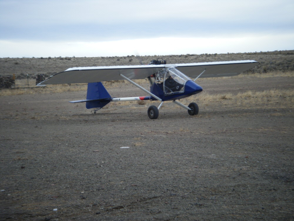

Eric,
I bought my full enclosure from Kolb, and it included the fabric and clear vinyl as well as a full sheet of Lexan, a hoop for the top of the enclosure, two side rods for the back of the Lexan and an aluminum rod for the center of the windshield.
While I used it for years and even incorporated a heater for really cold weather. I did not feel that it was as suitable as it could have been, and my enclosure has morphed to this design. I also found that the vinyl part that fully enclosed the rear of the cockpit cut my speed down by 5 to 7 MPH. I also found that there was not much noticeable difference in temp. as far comfort was concerned. I no longer use the vinyl part, a silk scarf and a rag wool hat over my headset, a Chili Vest with a pair of gloves and I am good down to 24 degrees so far. Not real interested in experimenting further in that direction.
Larry C, Oregon Firestar II

PostPosted: Mon Oct 05, 2009 5:24 pm    Post subject: Full Enclosure Reply with quote
Larry, you said "I did not feel that it was as suitable as it could have been, and my enclosure has morphed to this design" but I dont follow you as to what design you have morphed to? did you send a picture that I didn't get?

marenyi(at)gmail.com
PostPosted: Mon Oct 05, 2009 5:25 pm    Post subject: Full Enclosure Reply with quote
Larry, Nevermind, it took my email a while to show them, I see what you meant now!
Thanks!! Eric
