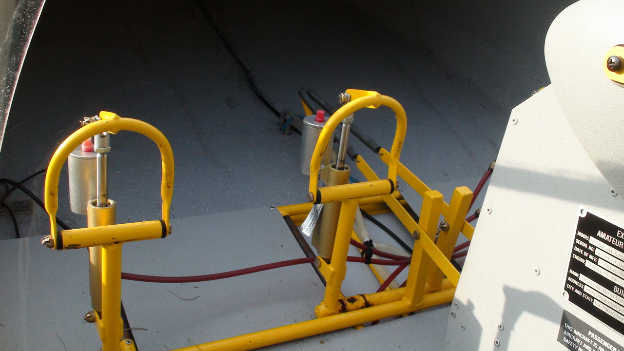

PostPosted: Fri Oct 02, 2009 7:58 am    Post subject: Re: Heel brakes or ??? Reply with quote
Toe brakes are the standard in the aviation world, from th smallest to the biggest planes. Toe brakes are not complicated or hard to make, it just seems that ultralight designers like to take shortcuts on this item. Reversing the brakes with the rudder pedals is just a setup for disaster, as albertakolbMKIII just pointed out with his experience. I have toe brakes, they don't weigh any more than a heel brake setup, the my Kolb has standard controls just like every other plane in the world. Heel brakes and hand levers can work, but its a design shortcut and substandard.
Mike
 Filesize:  270.39 KB
 Viewed:  23877 Time(s)
Kolb MK-III Xtra, 912-S
