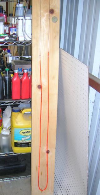

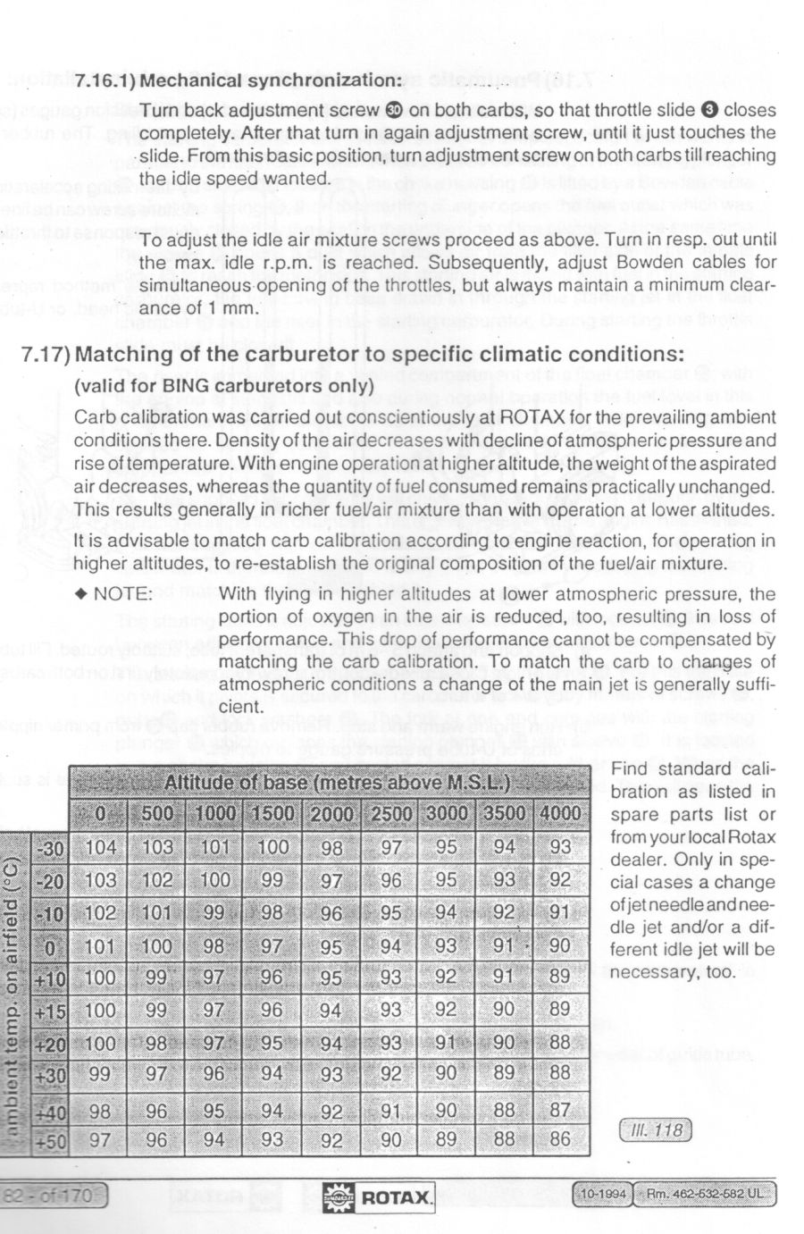

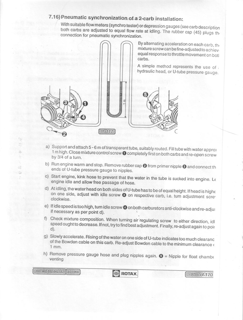

Here you go guys and gals. I'm not sure why Rotax has mechanical synching after pneumatic. I do it the other way, that's how it's spec'd for the 912 and my HKS.This is really so simple, it just seems intimidating until you do it once. As with all things done with a running engine, tie the plane down and have an assistant ready to hit mag switch(es) if required. Before you start raise throttle cable boots so you can get at the cable adjustment screw. Give each cable a tug to see how much slop there is. When you get to cable adjustment that's most likely the one that will have to be adjusted.
1. Adjust idle air screw per Rotax or Bing for your engine / carb combo.
2. Warm up engine to operating temperature
3. Hook up manometer (incidentally, someone on the list suggested two stroke oil instead of water, I used transmission fluid because I had it loaded into a pressure gun to fill the brake system on my trike. That is the easiest way to get the fluid into the tube. Using oil also makes the levels a little slower acting so you make an adjustment and wait a bit for the fluid column to react. It's also less likely to get sucked into the engine if one carb is severely out of synch to the other. To get the initial level set before you hook up to the primer port blow into the tube with the higher level until they're even.
4. Start engine and let idle. Screw in idle adjustment screw on carb connected to the fluid column with the lower level until the columns are even. If that makes your idle speed too high adjust each screw back out until you get the idle speed you want and both fluid columns are even. If you do have to back out an idle adjustment screw make sure you haven't brought the throttle cable up tight so that the carb piston is no longer setting on the adjustment screw.
5. Set RPM to 3000. Loosen adjustment screw on the top of the carb with the lower fluid column and screw out adjustment until columns are almost even and tighten lock nut (this will raise the column very slightly, which is why you don't want to get them exactly equal. It's not much but you are after perfection, after all).
6. Shut off engine, disconnect manometer lines and plug with an AN 3 screw so the manometer stays clean, replace primer plugs or lines.
I did my 582 while I had the wings off as spinning props make me nervous. I put an eyebolt (my local surplus store sells them cheap) in the board so I could safety wire the manometer to the aircraft, you could just as easily drill a hole and run safety wire through it.
That's it.

Oops! Hopefully I caught this before someone goes out to their plane and tries using my version of the Rotax instructions.4, Screw in idle adjustment screw on carb connected to the fluid column with the lower level ....WRONG, should be higher level. Higher level means more vacuum, opening the throttle lowers vacuum.
Screw in idle adjustment screw on carb connected to the fluid column with the lower level ....Well, at least I'm consistent, again should be higher level, same reason.
Sorry guys and gals, typed faster than my brain could follow and confused manometer and vacuum gauges. Didn't catch it until I was expanding the email text for an article in the Chapter 88 newsletter this evening.
My apologies if I caused any confusion.
Rick Girard
