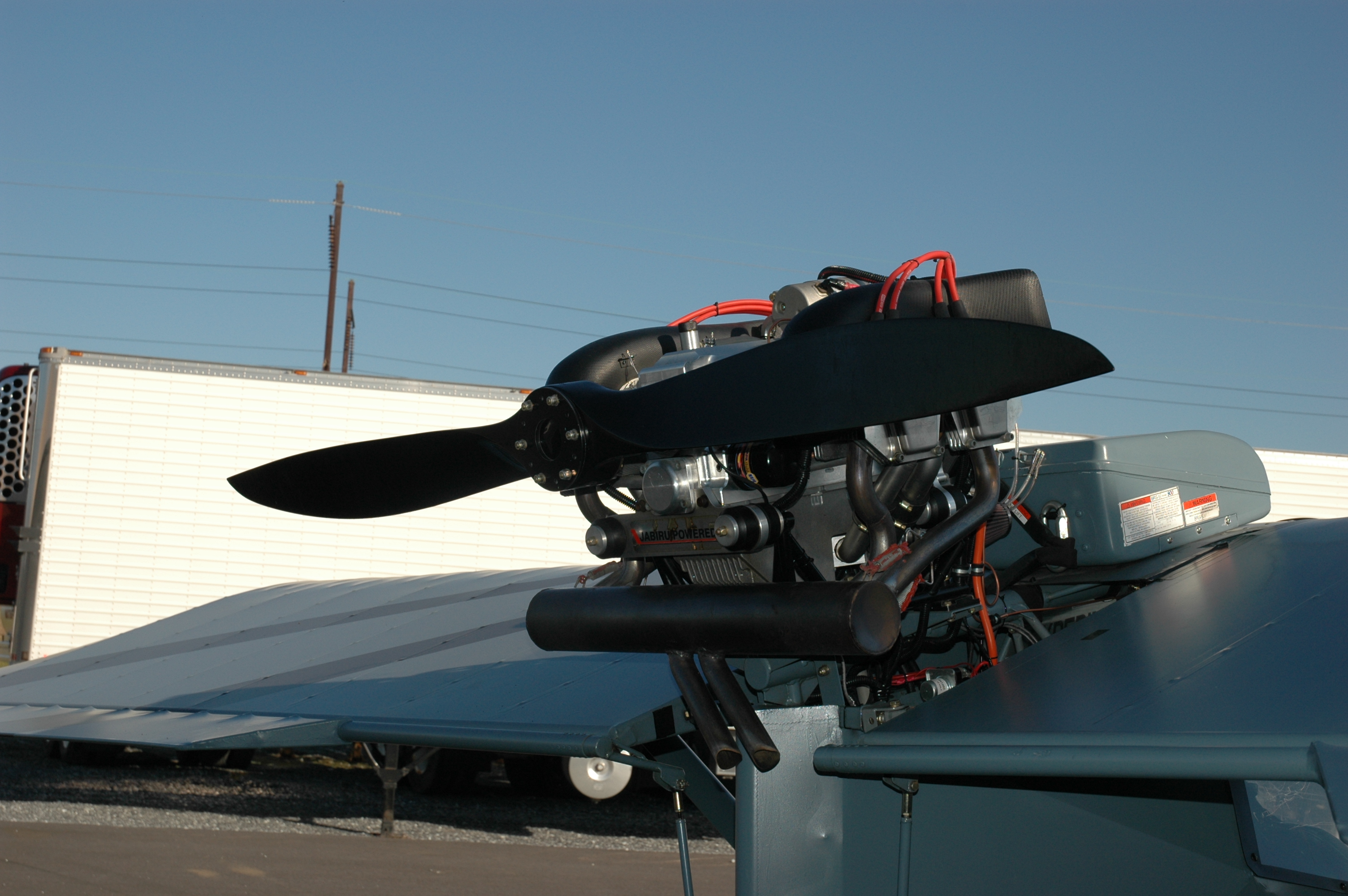

Thom Riddle
Posts: 1597
PostPosted: Fri Sep 25, 2009 8:36 am    Post subject: Re: Oil problem Reply with quote
Pat,
You must have a different sort of exhaust system on your Jabiru than I have. I wouldn't doubt it since your noise regulations are stricter than ours in the USA. Attached is a photo of the right rear quarter of my Slingshot. It is high enough resolution that you can zoom in for more detail. What you can't see because it is hidden by the prop, is the oil pressure sending unit (VDO). It is mounted above the base of the oil filter on a Tee with a hard copper line to the mechanical oil pressure gage and the electrical signal going to the EIS. As you can see, the exhaust sy
Thom Riddle
Buffalo, NY (9G0)
- Anonymous
Thom Riddle
Posts: 1597
PostPosted: Fri Sep 25, 2009 8:38 am    Post subject: Re: Oil problem Reply with quote
accidently hit return key,
....As you can see, the exhaust system is not in play with the VDO oil pressure sender. Do you happen to have a photo of your exhaust system installed? I'm curious about how convoluted it might be to get the silencing results required in the UK.
Thom Riddle
Buffalo, NY (9G0)
- Anonymous
Thom Riddle
Posts: 1597
PostPosted: Fri Sep 25, 2009 8:41 am    Post subject: Re: Oil problem Reply with quote
Senior moment again. I forgot to attach the photo. Here it is.

Hi Pat, There is one company called Thermotec that makes many products associated with insulating and controlling heat for automotive racing. They have a header wrap that is 1/16" thick by 1 to 2 inches wide offered in black or tan color that withstands a continuous 2000 degrees. Black would look good for your aircraft. There may be other products out there now but this product comes to mind as I used it many hotroding years ago. If you download their catalog from their website and go to page 4 you will see what I am suggesting. In addition and if needed, you could install some of the heat shielding material over the sender. I like their fire sleeving for wires. You only need two thumbs. Don.
