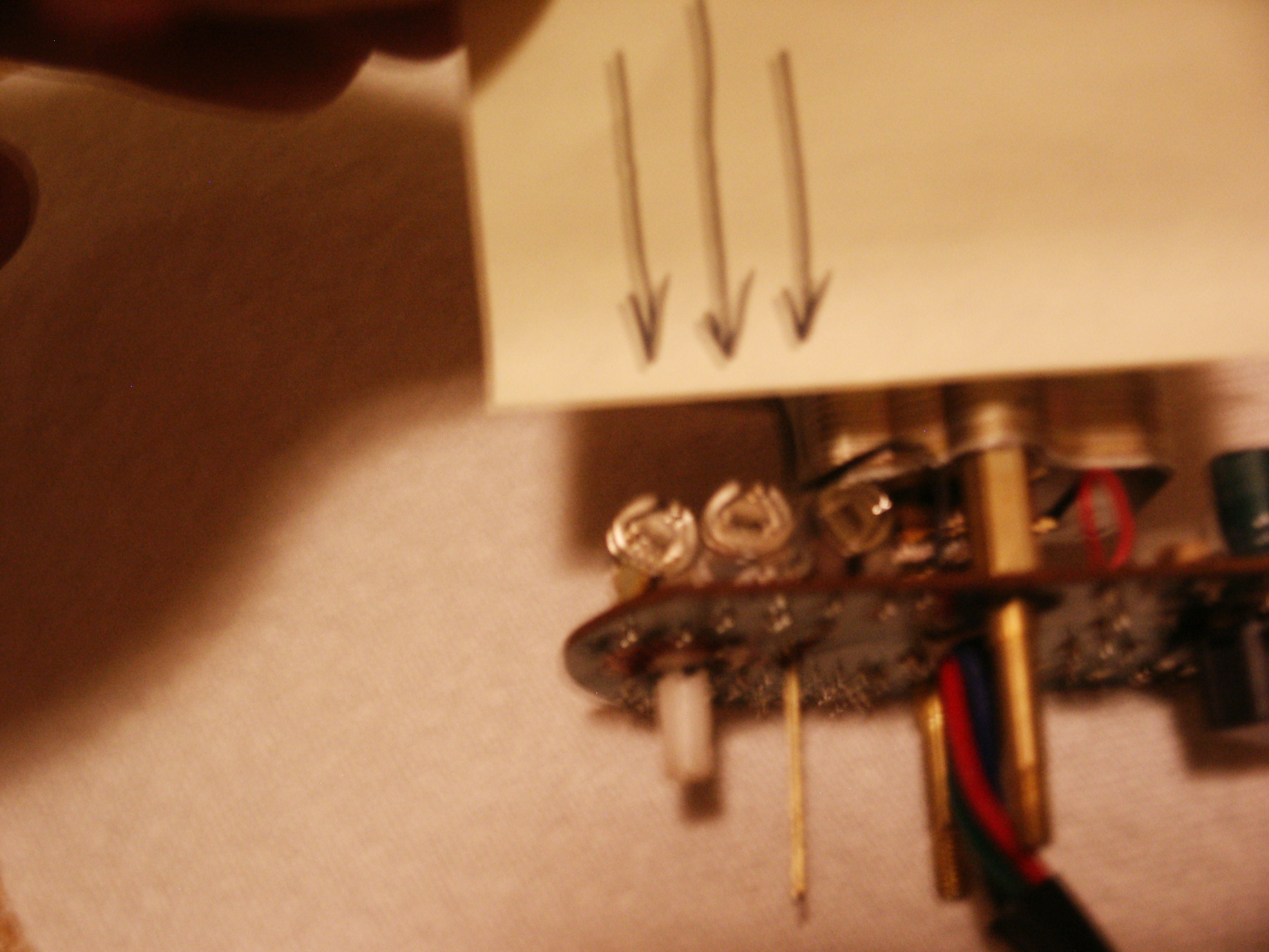

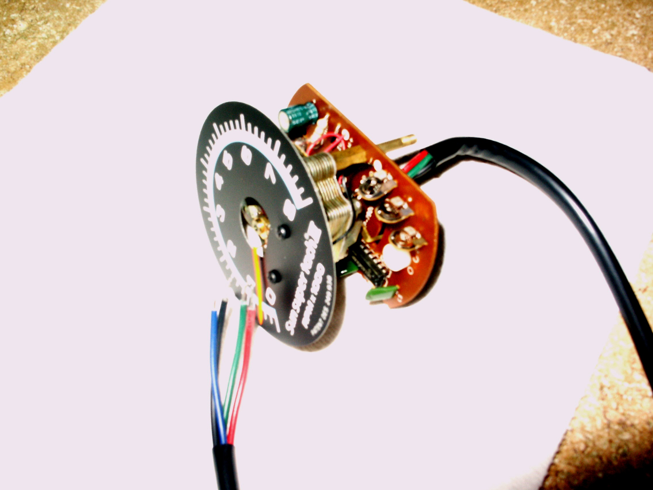

Mr. Bob C
  As we all know C a tachometer is a simple pulse counter.  It also may have a dividing or multiplying function C and C as an example C for every electrical pulse C it registers the accurate engine revs per minute.
  Most tachs come calibrated to work with the most common engine cylinder models C namely 4 C 6 & 8 cylinder engines.  Again C most tachs will reflect the proper rpm when the little switch in the back is clicked to appropriate setting.  The factory technician adjusts the internal potentiometer for each mode.
  I'll explain it a little clearer.  Let's say we have a 4 cylinder C 4 cycle engine C like a Rotax 912.
The tachometer receives an electronic pulse every cylinder "fire" (which happens to be every other cylinder rotation).  Inside the tach C there is an adjustable resister C a potentiometer.  The factory tech would have adjusted that "pot" to make the needle reflect the engine's accurate rpm (at the factory C they'd likely use an occilloscope C and a pulse generator for the actual calibration)
  Next C the tech would click the little switch to the 6 cylinder setting C etc. etc.  Lastly C the 8 cylinder.
  Now C as you know C there are very few (if any) 3 cylinder tachs.  It's not that the internal guts of a 3 cylinder tach is any different than any other tach C it's just there aren't very many three cylinder 4 cycle engines.
  So C for us rare guys that need a 3 cylinder tach C we can simply take the tach apart C turn the little potentiometer to a known desired rpm C and we're "good to go".  (this is where that handheld tach really comes in handy!!)  We just dial our Sunpro to read what the handheld says.
  I'll see if I can come up with a photo of the potentiometer you'd be looking for.
  Note:  I have a large size Sunpro C calibrated with an ocilloscope.  I don't like it.  Too big.  I have since bought a brand new smaller Sunpro.  I will use the larger model to calibrate the engine rpms to the smaller model.  I have to wait until I have the engine running C to do that.  Hopefully C I'll have it running by Christmas.
  For a guy to set a Sunpro up to work with a 3 cylinder C you'd want to first click it to the 4 cylinder setting.  Then C dial the potentiometer to match you handheld tach.  Easy.  Now C I'll go look for the photo of the insides of the tach.........

PostPosted: Tue Sep 15, 2009 5:42 pm    Post subject: Tachometers Reply with quote
Hi Bob C
  Wow C I never heard of the Sunpro coming with the 3 cylinder choice.
  Just in case anyone else is interested C I took a few photos of my larger Sunpro internals.
If a person wanted to adjust it to work with a 3 cylinder C instead of a 4 cylinder C you'd have to adjust one of the little potentiometers I pointed in out in one of the photos.  Which potentiometer??  I didn't look to see.  You'd have to find which one is activated when the switch is in the 4 cylinder position.  (not too hard to see which pot the switch is pointing at)
Mike Welch
MkIII CX
