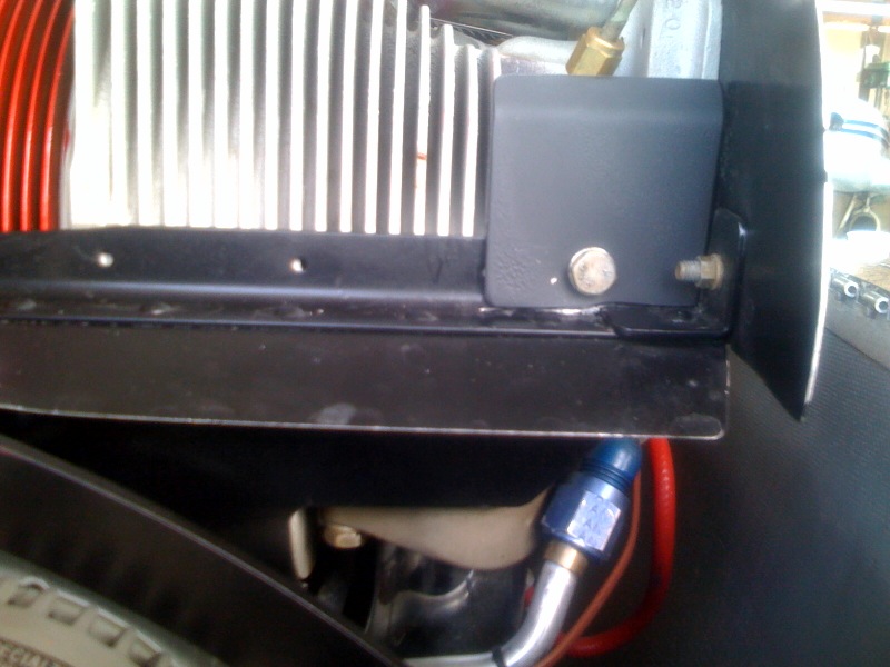

PostPosted: Thu Sep 17, 2009 4:43 am    Post subject: LOP (Lean of Peak) Injector Tuning Reply with quote
I have the standard inlets, but based on this list and Alan Barrett's
recommendation I put a small air dam in front of the front injector.
Raining down here this week so have not flown. Will keep you posted.
Gary Specketer

Gary,
Any chance of you posting a picture or sending me one. Plane gets out of the paint shop this weekend if WX cooperates and balancing is one of the items on my to-do list.

PostPosted: Thu Sep 17, 2009 6:19 am    Post subject: LOP (Lean of Peak) Injector Tuning Reply with quote
Here's one.
Tim Olson - RV-10 N104CD

partner14
Joined: 12 Jan 2008
Posts: 540
Location: Granbury Texas
PostPosted: Fri Sep 18, 2009 7:47 am    Post subject: LOP (Lean of Peak) Injector Tuning Reply with quote
Does anyone have a picture of this "air dam".
Thanks, Don

There's a photo about 6 posts up.
