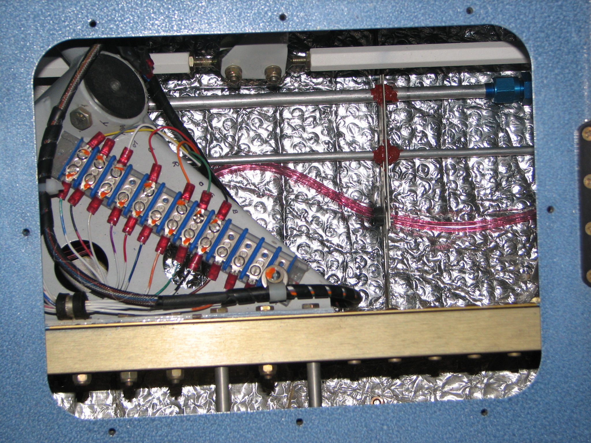

PostPosted: Mon Sep 14, 2009 8:04 am    Post subject: Infinity grip wiring. Reply with quote
Geoff, here's what I did... really simple.

PostPosted: Mon Sep 14, 2009 10:44 am    Post subject: Infinity grip wiring. Reply with quote
Thanks Don
That looks like the way to go. I was heading down that path as well.
Geoff

PostPosted: Mon Sep 14, 2009 6:58 pm    Post subject: Re: Infinity grip wiring. Reply with quote
I used a D-sub connector. This area tends to collect dirt with time so if you use the terminal strip then consider covering it in some way. Connectors are less susceptible to environmental contamination.
