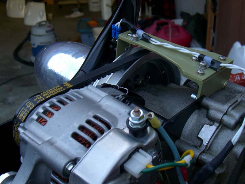

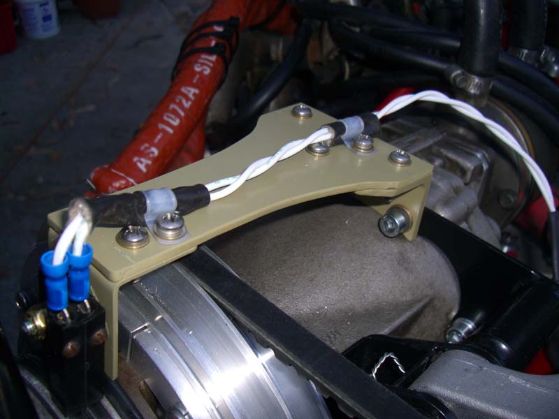

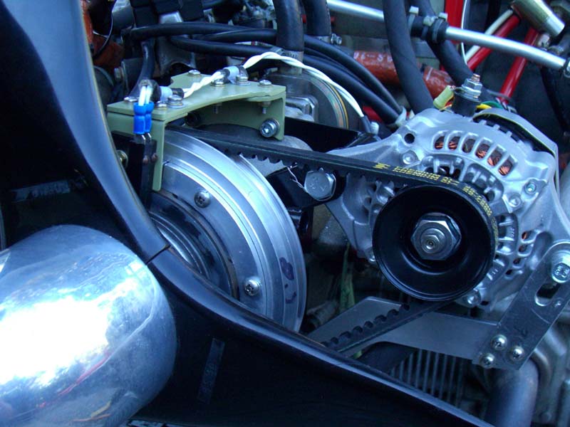

Hi C
Thought I would share Pix of my latest installation of Alternator.  No problems with night flying in the pattern.  Everything turned on and battery still charges at idle.  A few problems with Model IV with round cowl C but all worked out.
Clint
Working on 1500 hours.
From: clint_bazzill(at)hotmail.com
To: gammon25(at)yahoo.com
Subject: Alternator Pix
Date: Wed C 2 Sep 2009 15:34:11 +0000
.ExternalClass .EC_hmmessage P {padding:0px;} .ExternalClass body.EC_hmmessage {font-size:10pt;font-family:Verdana;} Here are a few pix of my installation.
Clint

PostPosted: Sun Sep 13, 2009 4:57 pm    Post subject: Alternator Pix / Kitfox IV Reply with quote
A few problems with Model IV with round cowl, but all worked out.
That is excellent workmanship. Very nice fabrication job. I especially liked your
mounting bracket and careful attention to wiring and vibration.
Thanks for posting the pictures. Perfect size for viewing.
