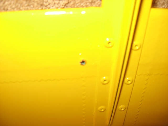

I have just finished melting holes in my newly covered wings. Outboard of each rib at the trailing edge and at the bottom of the rudder. They look like the ultimate invitation to nasty flying bugs looking to build nests to me. Does everyone have these holes? I need them with the moisture here in the Maritimes Should I use the little hoods? Am I concerned for no cause?

PostPosted: Sat Sep 12, 2009 7:44 am    Post subject: Drain holes in wings Reply with quote
Dave,
I wouldn't be too concerned about the bugs getting in, you can look for that on your preflight. I would recommend you protect the hole with either the seaplane grommets (little hoods as you say) or plain ones, it's your choice. I used the seaplane grommets just in case I decide to put my plane on floats. The grommets are used only to protect your fabric. The holes allow moisture to drain from inside the structure and everyone should have them. BTW, they are easy to put on.

Thanks Richard. I'll glue the hoods on. It was a poor picture but for those who care that is my first attempt at finish using Stewarts System water borne urethane paint. The whole system is very easy to use, has a fairly easy learning curve and is non toxic (mostly) and non flammable. I cannot tolerate the fumes from MEK at all, so a real boon for me. The Stewarts people are also top notch at customer support.

PostPosted: Sat Sep 12, 2009 2:06 pm    Post subject: Drain holes in wings Reply with quote
The hoods will also mask the fact that you should have burned the
holes BEFORE the application of the color coat. I believe that
admonition is covered in the Poly-Fiber manual. Doesn't the Stewarts
System tell you that? Sorry to be the bearer of bad news but somebody
had to.

Did somebody really have to? No problem, it's one of those things I figure
can be done when it's convenient, if that turns out to cause a problem, then
I was wrong, wouldn't be the first time. The Stewarts system does not
mention drain holes at all, and I have not seen them use any in the videos.

Too late for seaplane grommets now if you already painted. Make sure you got drain holes in flapperons as well at elevator and bottom of fuselage at rear. If and when water gets in you certainly want it out. I would not worry about bugs much.

not quite.. I put mine on (sea plane grommets) after the paint. A little Plast-i-zap and some paint and you would never know the difference. So far, they are holding on just fine.

When I said "somebody had to" (mention that the drain holes should
have been burned into the fabric...preferably during the Poly Spray
stage of the Poly Fiber process), it was to let you and *others* know
that by doing so, the burned edges of the holes can still be sanded,
THEN painted and thereby prevent the burned look the the pictured
holes display. The goal of this List is to let each other know the
proper way to perform certain tasks, and that way we all learn. I
used the Poly Fiber system, and they teach...I believe in their
manual...that the holes be burned at the Poly Spray stage....the
sanding stage, so that the final color will cover the burned and
sanded area, even IF no sanding is done. My comment was not to
degrade your work, but to let you and others, who may still be
building/learning, the proper procedure for burning the drain holes.
If you took exception to my remark, I apologize, but it was done for
the "greater good" as the popular phrase these days goes. As to
adding the so-called "seaplane drains" (I think they are called),
yes, they can be added after the paint, as they are clear, at least
the ones I've seen, and won't really detract from the finished
appearance of the job. And it wouldn't be the first time I was wrong
either. : )

I was largely of the same opinion. I'll scuff up a small circle and glue
them on, they're very cheap and light and if one falls off from time to time
it won't hurt anything.

Hi Lynn, no worries about my taking the criticism badly, I simply assumed
you were tossing a little light hearted ribbing along with "best advice",
absolutely no harm done and I appreciate you looking out for people. I've
never seen you shoot across anyone's bow and would afford you the benefit of
any doubt regardless.
I gave this a little thought before failing to put them in and figured it
would not matter if I waited. I know you are absolutely right about the
timing, everyone does it that way, but the manual is not clear about it. The
reference to it in my Polyfiber manual (ver 20) is on page 51 where they
don't really state when except that if you're using dollar patches you would
have to do it when taping obviously. There's also a small reference on page
64 listing things not to forget before spraying. So I came away with the
opinion that as long as reinforvent is appropraiate they could be put in
anytime and as required. Perhaps a later manual is absolutely specific about
timing but mine was somewhat ambiguous so I ignored it until it was
convenient for me. I am absolutely defying their requirement for size
though, mine are slightly smaller than the required 1/4".

Hi Dave-
I just recalled another gem of wisdom, and I don't recall of the
manual says this or not, but use a metal washer laid on the surface,
and that will control the diameter of the hole, as well as keeping
the flow of molten fabric from coming up. The washer will kinda force
the melt downwards. I also can't recall where I read or heard about
it....maybe it was from Jim Miller of Poly-Fiber in Columbus,
Ohio...but he said that the holes didn't really need reinforcing
doilies, because you are *probably* going through 3 layers of fabric
already at the point where the drains go. And he also said that the
plain washer-like reinforcing grommets weren't necessary for the same
reason.
Speaking of when to do the burning of the holes. when I got my
partially finished plane, the drain holes had been burned into the
TOP of the horizontal stab. So I had to patch those up (with
rectangular patches, according to Jim Miller, so that they wouldn't
be so obvious), and burn holes into the bottoms. I thought I was just
about to start spraying color when the light bulb came on and I
remembered to burn the holes...AND i damn near burned them in the TOP
surface again! Sometimes the old brain just needs a wake-up call.

They make thin aluminum washers for that purpose.  Just polytak them and use sharp exacto knife to cut out fabric in center.  Very nice looking and very easy.

Hi Dave-
I just recalled another gem of wisdom C and I don't recall of the
manual says this or not C but use a metal washer laid on the surface C
and that will control the diameter of the hole C as well as keeping
it...maybe it was from Jim Miller of Poly-Fiber in Columbus C
Ohio..but he said that the holes didn't really need reinforcing
doilies C because you are *probably* going through 3 layers of fabric
reason.
partially finished plane C the drain holes had been burned into the
rectangular patches C according to Jim Miller C so that they wouldn't
be so obvious) C and burn holes into the bottoms. I thought I was just
