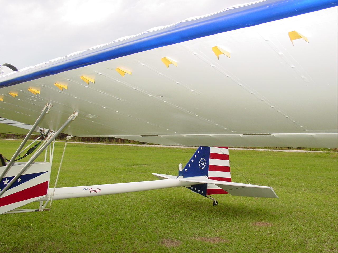

Despite Brother Pike's reference to improvements from the VG's, still getting mixed results and experimenting with the placement. Not totally satisfied that these things work that well. Am currently back 11.5 inches from the leading edge, (see photo) but thinking of reducing this to about 10 inches. Have some more testing planned with yarn tufts to see where the boundry layer is breaking away...
You mentioned that your machine wasn't a Kolb... What kind of airfoil are you working with...?
beauford
FF-076
 Filesize:  584.02 KB
 Viewed:  15363 Time(s)

beauford
FF-076
http://forums.matronics.com/viewtopic.php?p 62133#262133
http://forums.matronics.com//files/vginstalljpg_554.jpg

Yes... I know... guilty as charged, Brother Bean... bad boy...
The photo is an old gag... although I'll bet someone has tried them down there...
Brother Waltman:
The Landshorter clear lexan VG's Brother Pike referred to seeing when he was
visiting are right up on top of the wing at 10% of chord exactly where the LS
people said to put them. Substantial performance improvement over the homemade
aluminum jobs, which were at 11.5 inches. I don't have the exact measurement at
hand, but the Landshorters are roughly 2.5 inches forward of where the old
aluminum ones were.

'Ol bad beauford is going to now punish himself for posting the gag picture by
going to bed without any (more) supper.... although he may get himself just a
taste of cheap brandy and a Cusano 18 stogie and sit out back a while before
bed...no sense in going Draconian over this... He'll be meditating about paper
VG's...

>From the above info, am I to assume all airplanes use the same number of
>VGs? i.e., Fire Fly with 22 foot wingspan uses same number as MKIII with 30
>feet?
..Well...I reckon you COULD get all 100 of 'em on the Fly, John... but it might
look kinda like a cheese grater from the front.... and would likely sound like a
harmonica band going by...
Actually, the Landshorter package provides an assortment of templates to make sure
that the installer sets them on the wings of a given airplane at an efficient
interval and exactly the right angle of attack...they make a big deal of getting
the angle of attack of the VG precisely correct, and the templates will do that if
one pays attention to them. I had about 28 of the original 100 left over on the
Fly as I recollect. When I ordered them the lady at Landshorter mentioned that
while most folks just keep the extras as spares in the event some fall off, she
said that some customers who have shorter wingspan machines use the leftovers at
other places such as the tail feathers... I decided to leave the old aluminum
items currently on the bottom of the horizontal stab and both sides of the
vertical stab on the Fly where they are... mainly because they are danged hard to
get off, even after soaking. I tried. I'll keep about 8 of the Lexan extras in
case I eventually lose a few off the wings... will likely replace the five large
yellow ones on the helmet with the remaining 20...
Speaking of losing them... I have yet to have a single one of the Lexan units fall
off... Landshorter recommends a certain Loctite #401 industrial-strength
cyanoacrylic clear cement, basically a souped-up crazy glue, to put them on
with... they sell the stuff and I ordered a tube with my VG's. One thing,
though -- one had best know EXACTLY where, and at what angle, one wants that
doober BEFORE it touches to the fabric...or your thumb.... your stogie... the
cat.... your left nostril..... whatever. The word "adjustment" is clearly not in
the Loctite #401 vocabulary....even one nanosecond after first contact. Kinda
reminded me of our honeymoon....
So far -- So good, with these things... as already mentioned, a remarkable
positive difference from the VG setup I previously had...
..worth what ye paid fer it...
beauford
FF-076
Brandon, FL
