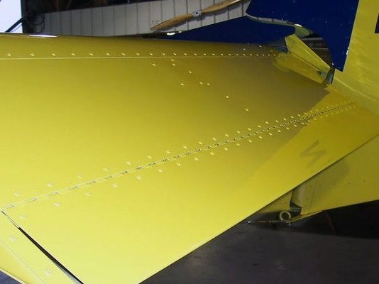

Has anyone tried to build the elevator trim tab like the ch750 i would like to get the tab incorporated in the elevator. Looks cleaner and less chance of me giving it hanger rash.

I just ordered one from Shirley! Razz
The part is really complex and is not very expensive to buy.

[quote="Chris Lewis"]I just ordered one from Shirley! Razz
I dont understand i was under the impression that zenith is selling the older style tab for the 701.

I'm building a 750 and this allows me to buy parts as needed. The 701 elevator has a different TE, so you'd need to fab your own internal trim tab to match. Not really hard to do.
The 750's trim tab is a complicated multiple bend affair and I figured I'd ruin more aluminum trying to duplicate it than it was worth.
