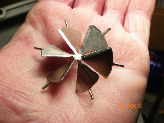

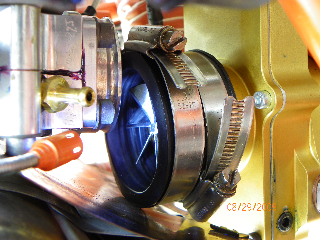

Last week or so, I mentioned I was going to build a "turbulator" for
my induction system. Here are pictures of what I built and what it
looks (looked) like installed.
I cut and bent it out of stainless steel. The little "stems" sticking
out of the tops of the vanes are what is used to hold it in place. I
bent the vanes to about a 45 degree angle. After installation, I ran
the engine up, and it seemed like the rpm's were fine, but on
climbout it was about 200 rpm down, and pretty weak in climb. I
thought it might have been the quite strong wind I was fighting, but
the next day wasn't any better so I removed the device and power was
restored. In retrospect, I think if I had made the outside a complete
circle, and let the center of the vanes be more open...in other
words, just have the vanes at the periphery, I think it might have
worked. But I do not have the means to saw to the inside of a circle
on my bandsaw...no blade welding attachment. I may try this
experiment again if I can find a way to make it here at home.
By the way, this device is not intended to rotate. It is just
supposed to make the air rotate, or become turbulent.

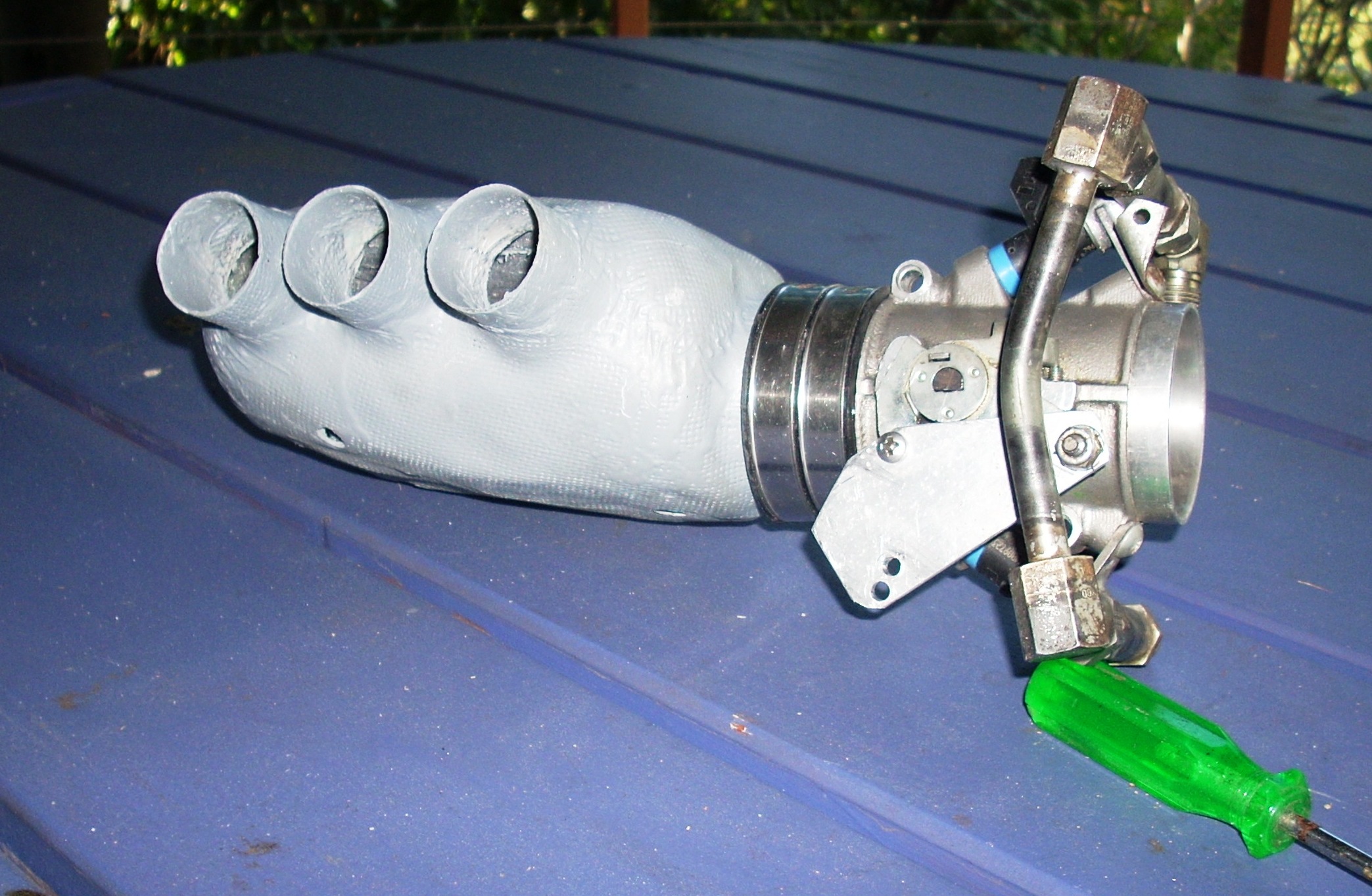

PostPosted: Sun Sep 06, 2009 8:59 pm    Post subject: Here's an idea that DIDN'T work Reply with quote
Lynn
I tried a device like that and fitted about 6" upstream from the carb. but
did not see measurable improvement and it limited power so that the last
11/2" of throttle made no effect.
After 12 months of trials using a Jenvey throttle body and two injectors I
made a number of different plenums to replace the induction collector
supplied.
Because the Jab collector is fed from the end I found that fuel mix
distribution was not uniform throughout the power range and at times uneven
distribution R to L was causing the engine to vibrate. Also at WOT when the
butterfly is horizontal there is a significant reduction in turbulence and a
tendency for the heavier fuel droplets to accumulate at the far end,
enriching #1 and #2.
Using a bowl shaped plenum (as attached here) the effect was so bad that the
engine would shut down over the last inch of throttle with #1 and#2 miss
firing rich.
Based on static RPM I got no extra power from the plenum because the engine
failed rich every time.I spent hours trying to figure out why the breakdown.
I was able to correct this problem by fitting a 11/2" wide plate inside my
plenum placed about 1/2" directly in front of the inlet, like a big baffle.
Then the setup behaved exactly like the Jab collector. #1 and2 were rich at
WOT but the engine did not break down. I got the same max RPM, but noticed
that there was no increase in RPM for the last inch of throttle opening.
I have the same effect with my jab collector.
From all of this I deduce that
1. The collector as supplied suffers from internal losses which limit
max power at WOT. and prevent rich failure of #1 and#2
2. There is the potential to make a plenum that would solve the problem
provided it has symmetrical outlets and is fed from the centre at the
bottom.
3. There is the potential to get more uniform distribution of the
charge and with less induction losses there is the potential to get more
power.
That will be my next project but at present I have a lot of other
commitments.
Cheers
Peter

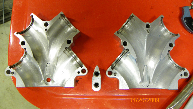

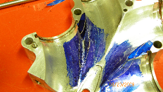

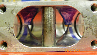

PostPosted: Mon Sep 07, 2009 2:56 am    Post subject: Here's an idea that DIDN'T work Reply with quote
Hi Peter-
I've been wondering how you've been making out with your injection
experiments. I too have been thinking about making the fuel
distribution unit more centrally located, and came up with the
thought of mounting my TBI below the engine, so that the intake tubes
would all be equal in length ( your potential item #2) and not have
to compete with each other for the incoming charge. Based on what
I've learned while using this TBI and running "lean of peak EGT"
tests, I made the pictured modifications to the intake manifold/
splitter, and it seems to have brought the front cylinders a bit
closer to the rears in terms of EGT and CHT numbers.
Now when operating the engine lean of peak, the EGT's are within
about 60 degrees F, and the CHT's are within a maximum of 20 degrees
F., and as close as 1 degree of each other. I haven't tried to see
how close the EGT's and CHT's would be at higher throttle openings,
but I will.
Because of the title of this thread, I should state that these
pictures are of an idea that DID work.
The first picture shows the area that I would remove from both
halves, and the second picture shows that removal with just the lower
half of the manifold/plenum done. After doing both halves, and test
flying it, it seems to have helped the distribution of air to the
front cylinders. At least it didn't hurt, and that's always nice when
you're potentially ruining an expensive part. : )

continue with this idea. I think if I tried to use the present piece
and bent it more, the vanes would break off, but making a new one
would let me try that idea. I try to use only the tools I have at
home here, but it may be time to go to a local machine shop for help
on this one. I originally was going to make it out of aluminum, but
it was going to be a major amount of milling, so I tried the
stainless steel and the band saw.

Lynn, Just a thought, but any airfoil surface, even a flat plate
will stall at about a 12 to 16 degrees angle of attack. Before you
give up, try bending the vanes to something well below this, say 8
to 10 degrees.

Thanks for the input. Tex....after I got to looking at it, I realized
that the vanes were too large, but thought that the edge thickness
was not too much of a restriction, but the air moving through it had
different ideas. : ) And yes, this was just a regurgitation of an
old idea.

Lyn, your idea is like what was tried many years ago. JC Whitney
used to sell them for cars and motor cycles. They had them
installed at the air cleaner and spun the air prior to the carb.
Also you have them too large a surface area. Cut them down a little
and I think you will get better result. Tex

Is there any way to change the shape of the support bolt housing to tear drop?The round tube has to create a lot of turbulence down stream.

Lynn Matteson
Posts: 2778
PostPosted: Mon Sep 07, 2009 8:10 am    Post subject: Here's an idea that DIDN'T work Reply with quote
Do you mean the thing that sits between the upper and the lower
halves of the manifold? I refer to this part as the splitter, and
when I spoke with Pete about its shape, he said that Jabiru had done
some testing and found the present shape to be the best. Here is a
picture of that part and as you can see, it is already teardrop
shaped when viewed from above. I had a notion to carve it into an
hour-glass shape, (as seen viewed straight on, as in the picture I
sent previously) and I still might, the next time I have the manifold
off the engine. The only problem with that idea is that there is an
(unused) threaded hole back at the narrow part of the teardrop, that
would be exposed if I carved it to an hour glass shape. I thought of
simply screwing an aluminum bolt into this hole, then proceeding with
the shaping of it, but decided not to...guess I chickened out. That
rear hole could also be filled with some structural adhesive/epoxy/
whatever, and then it would just be carved away as the shape took
place. The front hole...the only one that gets used in the actual
assembly...has enough meat around it, that it would allow some
carving away on either side of it. Just to make sure we're on the
same page here, this shot shows that splitter from above, and I would
cut away on each side of the splitter such that the plan view of the
splitter remains the same shape, but when viewed vertically, the
sides are narrowed...like a good-lookin' babe in great shape when
viewed from the front (minus a few of the "accessories" of course).
And of course when I say the "rear hole" it is actually toward the
front of the engine in a tractor environment, but it is in the rear
of the airflow.

On Sep 7, 2009, at 10:07 AM, zeprep251(at)aol.com wrote:
Lynn,
stream.
Gary Aman Jabiru 2200A 475 hrs

Something you may want to try is to replace the "splitter wing" with a round
bar stock 12mm in dia. I have had some customers try this with good results.
The theory behind the round stock it it cause's turbulence in the plenum for
better fuel distribution? But the guys that have done this report the EGT's
are more uniform between the cyl's..

> Just a few thoughts, a device that takes the "wet" flow of air
> and fuel and imparts a centrifuge effect will tend to throw the
> heavier droplets to the outside. I also remember a device that used
> four counter rotating vortices, created by bending metal tabs
> protruding inward from the inside of a large hole in sheet metal
> and claimed to solve the separation problem. I thought it was
> called Swarrup, or something like that, but when I tried to search
> the net I found nothing.
> Thank you for the pictures of your manifold. Heavier droplets of
> fuel retain their kinetic energy and do not want to turn with the
> air only to slam to the front for 1&2. One could wonder what would
> happen if the center divider was completely removed, what
> encouragement would the high velocity fuel and air have to
> alternately flow to the rear cylinders (3&4).

Looks like good work Lynn. Maybe you have got the splitter as good as it can
be.

Hi Lynn,
Yes it was a product called "Hiclone" overpriced at AUD160 and very heavily
promoted as a boost to power and economy.It has a double row of vanes in SS.
The idea is probably OK but I think any benefit is offset by the choking
effect as the device limits airflow.
I think it would work better if the diameter was much larger, then perhaps
tapered to the TB entry. This would accelerate the swirling air with limited
obstruction to the flow.
BTW I found it useful to conduct some tests using a high pressure spray of
water from a spray gun.
Peter

The induction collector is bolted flat to the sump.
When I discussed this with the Jabiru design engineer he admitted it was a
compromise. Heating the charge reduces efficiency but improves the
distribution as you suggest.
Peter

Jim,
Afriend of mine has replaced this part with a half round shape with the flat
at rear and he claims an improvement in distribution.
But I intend to continue with experiments for a bottom fed symmetrical
plenum.
