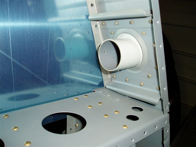

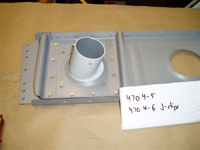

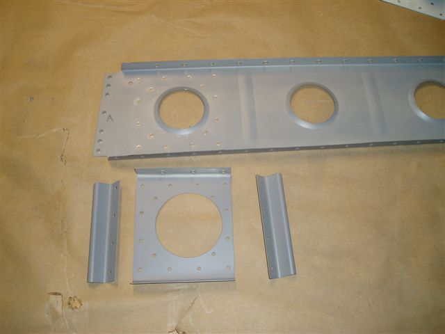

I put in a doubler plate and some J channel to
strengthen the step attach point. I can dig up and
attach the pics if there is interest. Also ordered
extra stall warning sensor access panels and will be
putting these in the baggage floor to access the step
attach hardware. (also for inspection, etc)

Photo's attached. I used scrap channel and flat stock
for parts. If you have not started yet, build the
doubler before you dimple the rib and it will go
easier.
Planned access panel location shown. this is same as
stall warning sensor panel on wing (order more from
Vans)
When I get to installing the step itself I will add
more j-channel to inner rib.
Eric

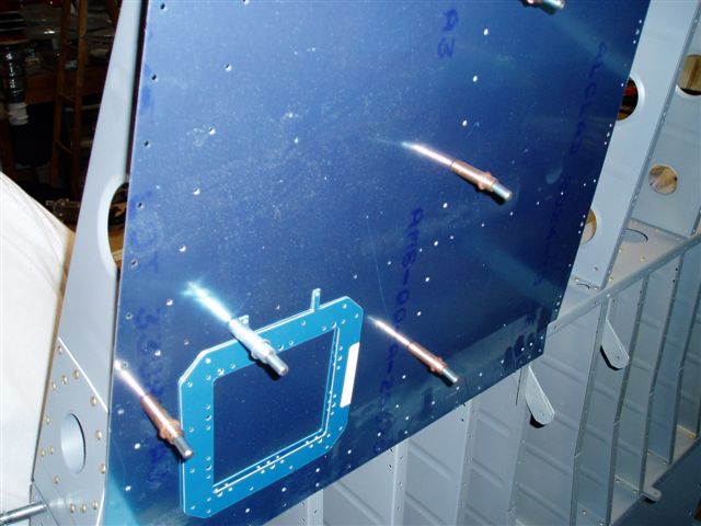

PostPosted: Sat Apr 08, 2006 4:49 pm    Post subject: Where to start on QB fuse? [step wobble] Reply with quote
Don't have a pic yet of them installed, but this is what the access
panel looks like installed. Sounds like several of us had the same
idea. Just remember that you have to drill the step so that you can put
the bolt in sideways...You can't get the access panel far enough
outboard that the bolt will go in vertically.
PJ

PostPosted: Sat Apr 08, 2006 4:57 pm    Post subject: Where to start on QB fuse? [step wobble] Reply with quote
I think this is a very very good modification. You'll be
really happy down the road if you ever have an issue, but
you're also well-prepared to not have any issues.
Very good, Eric.

PostPosted: Sun Apr 09, 2006 10:33 am    Post subject: Where to start on QB fuse? [step wobble] Reply with quote
Thanks Tim - Glad you liked it,
For those considering similar, I forgot to mention
that due to the j-channel there is one rivet on the
underside that you will have to put in an MK-319-BS or
similar. Also make sure that the j-channel and doubler
don't interfere and rub on adjacent parts in the
installed position and leave a little room for flex.
I was motivated by having to recently rework the step
and step area on my Cherokee 180. I caught mine in
time before it started to corrode but the dissimilar
metals make this a challenging area.
