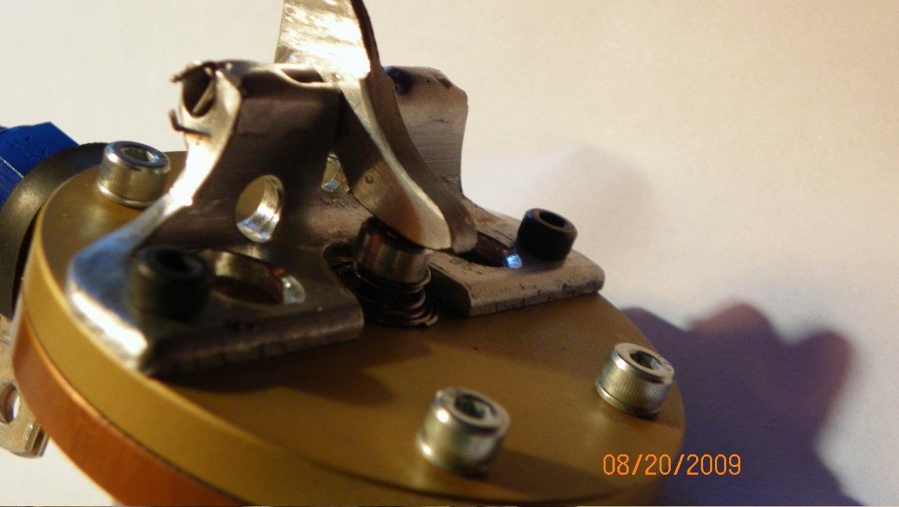

Here's a picture of the primer actuator that I built for my Rotec TBI
regulator. The top of the picture is cut off, but there is a control
cable that attaches to the upper arm of the bellcrank, and is
operated from the cockpit.
