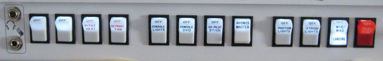

RV-List,
  In the past I have mentioned that a number of pilots have said how bright & noticeable my Dual Wig Wag HID lights are from the ground when I am on approach during the daylight hours. This is exactly what I wanted from the first day I saw my neighbor’s Pilatus swoop into our home field with his flashing HID’s a blazing. I think the little boy inside of me said… “me want.”
  Well yesterday on a dusk flight departing the LA basin ATC called traffic “South West 737 you have RV-10 Traffic 10 O’clock, 17 miles 8,500 feet. November 110EE traffic 2:00 O’clock descending out of one-one-thousand feet a Boeing 737.” Before I could respond the South West 737 replied Traffic Insight. Moments later the SW pilot told me through the controller “that is some light system he has on his RV-10, it’s really easy to pick up” COOL! Getting “at a boy’s” from commercial pilots.
I consider the Wig-Wag HID’s to be an important safety feature on my -10. Seeing is avoiding.
  The set up is nothing out of the ordinary with the exception of dual 35W HID lights placed in the leading edge. If interested I have a page that shows the install. http://www.painttheweb.com/rv-10/Lights_LEDHID.htm . One more thing of note. When on that page you will also see some pretty expensive (but nice) LED Position Lights. My next build is an RV-8A and I have found a set of Red & Green LED bulbs for around $8.00 each including wired sockets (eBay). These appear to be an excellent and cost effective solution vs. the printed circuit board LED’s I used on my -10. Plus some significant time savings to install as well. I will report results once flying.
Not exactly the LED’s I purchased but this gives you an idea of the concept: eBay Item# 380151029392
Robin

PostPosted: Thu Aug 27, 2009 6:42 am    Post subject: Big Iron Envy Reply with quote
Pat,
                Not sure if you are asking me about “switching� or “wiring� but the wiring is straight forward as we followed the instructions included in the XePulse unit. As far as the switching goes my Landing Light switch is a 3 position Off, On, Wig/Wag. I set up my switches so that the four switches I want on for Take Off/Landing/Go Around are all together Fuel Pump/WigWag Landing Lights/ Strobe Lights/Position Lights. So my quick & simple Take Off and Landing double check is “All Forward� meaning Mixture & Prop and “All Up� meaning Boost Pump and Lights. For night Tale Off & Landings I move the WigWag lights to the middle position for solid light operation. One other note: my Gulfstream550/SW Airlines/Acrobatic Pilot/Instructor tells me that if I want to be “cool� I should taxi with landing lights full on to let them warm up (the XePulse controller warms them up for me) and then once I receive the “Cleared For Take Off�  call I flip on the WigWag as a visual acknowledgement of the clearance. I only experience a 1-2% increase in personal coolness when I do this. Heck I already have an RV-10 how much cooler do I need to be?
                BTW I have the Landing Lights adjusted so my right light during ground operations projects out about ~1200 feet (these lights are very powerful) and my left landing light only about 100 feet. This makes the left landing project out ~1200 feet in the landing/flair configuration. Again these lights are so powerful that with our runway lights on full bright and short final I can light up the numbers & centerline and see the light patters oscillate and the plane makes small pitches & rolls adjustments on short final.
Robin
