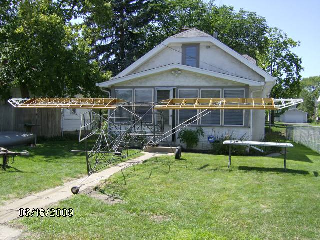

PostPosted: Mon Aug 24, 2009 5:38 pm    Post subject: Re: Wingtips Reply with quote
JP-KMA
 Filesize:  113.19 KB
 Viewed:  18348 Time(s)

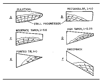

Wingtips and induced drag in low altitude, light aircraft.
http://www.freewebtown.com/salil/Drag/Page8.html
Based on this, when I rebuild Ed's FSII, I think I will go with whatever is structurally easiest, lightest, and uses whatever we have on hand.
Richard Pike
MKIII N420P (420ldPoops)
PostPosted: Mon Aug 24, 2009 6:38 pm    Post subject: Wingtips Reply with quote
Richard Pike
Richard P:
Enjoyed reading the referenced page.
I mentioned Homer's wing stalling at the root first, in a msg to the List
the other day. Didn't provoke any response, yea or nay.
This is a good illustration of progression of different style wings.
Homer's wing would be wing B. This is the reason we have such gentle stall
characteristics, if we don't screw with Homer's design. Also why we can
still maintain roll control right through the stall, because the ailerons
are still working.
"The other problem with elliptical wings is the stall characteristics. It is
much safer to design an airplane so that the wing stalls first at the root,
leaving the outer portion of the wing, (where the ailerons are) still
flying. An elliptical wing however, will tend to stall uniformly all along
the span (see the diagram below.) The "fix" for this situation is washout,
but that will reduce the theoretical gains in induced drag. Therefore, we
are unlikely to see a great resurgence in the use of elliptical wings,
except in situations where appearance dictates."
 Filesize:  3.79 KB
 Viewed:  18349 Time(s)
PostPosted: Mon Aug 24, 2009 6:42 pm    Post subject: Wingtips Reply with quote
 Filesize:  3.79 KB
PostPosted: Mon Aug 24, 2009 6:44 pm    Post subject: Wingtips Reply with quote
The illustration is in the attached file.
I didn't notice it when the msg came through first time.
 Filesize:  3.79 KB
 Viewed:  18350 Time(s)
