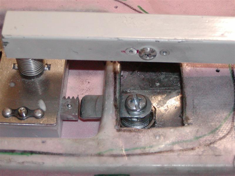

I just sold my RV-10 so I can't take a picture. In the locked position, the locking arm swung downwards in front of the lower gear rack. In theory... this would provide a stop and prevent the lower gear rack from moving forwards.
In practice, it only took a little force on the door handle to strip the lock and open the door. My neighbor accidentally stripped his lock also... it was mostly decorative.
This type of lock should probably be mounted at the bottom of the door and the arm should swing through a slot to engage the door frame. This would subject the lock to shear loading, rather than rotation. -David

for $4.86 one can get a simple lock from Lowes or HD and build a relatively
solid locking system (William Curtis has a picture on his site). No
different than the baggage door. I built mine so the handle can not be moved
at all, there is a .063 plate between the door and the lock pop riveted on,
sure with some serious pulling the lock might eventually give but it would
take some work and a ruined door, most thieves give it a quick pull, see it
doesn't bulge and move on to the next possible victim.

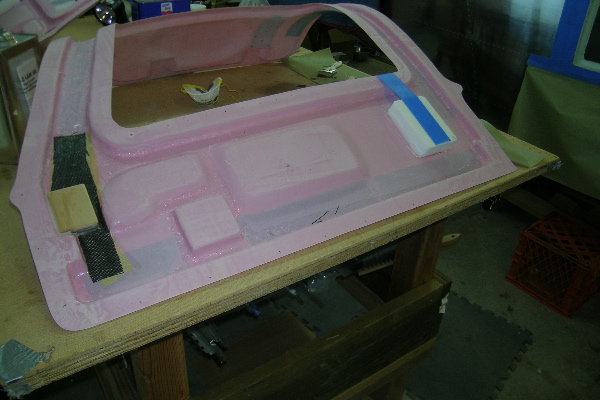

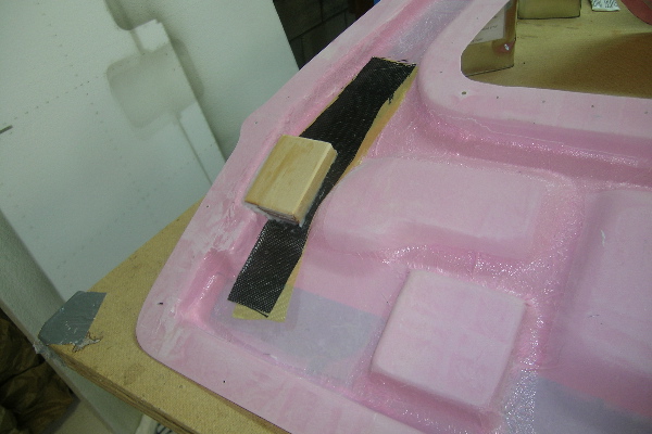

This will give a few builders ideas about where a lock can be placed. This is a piece of hardwood. I intend to place a lock similar to the one that locks the baggage door. It will ingage the front inside part of the cabin top. I placed it in the front edge of the door for two reason: to manually close the latch while flying so that if the door were to pop open(it won't afer I improved my pins and achore points) it would prevent the air from grabbing the door. Two C easy to see for both the pilot C co pilot while in the air and the thief while on the ground.
Note the extra carbon cloth and the Kevlar backing  which I used on both sides of the door. The foam in the second picture is to make the door more rigid in that area.
John
