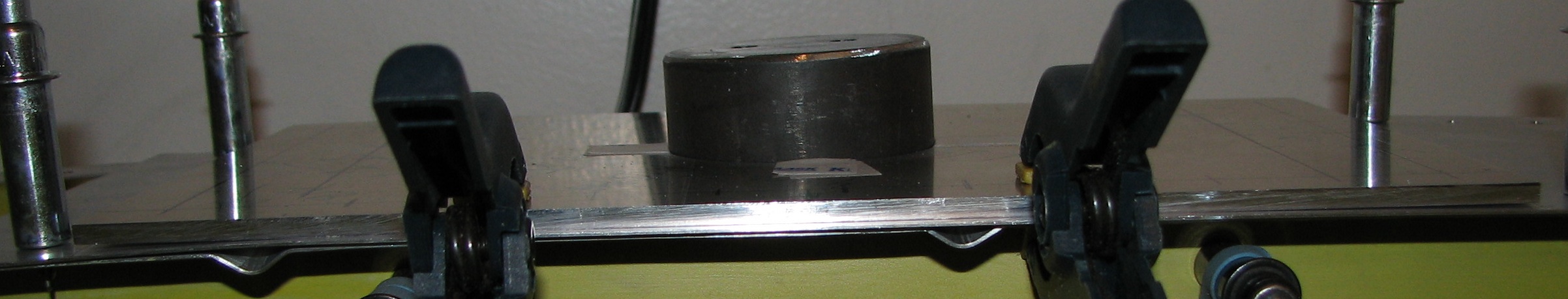

Did anybody bother to bend plate 6V11-4 to fit the curvature of the wing?
I see small gaps at the front and rear, something around 1.0 mm ... see attached file...
Carlos
CH601-HD, plans
 Filesize:  251.95 KB
 Viewed:  4209 Time(s)

PostPosted: Mon Aug 10, 2009 4:20 pm    Post subject: centre wing, HD(S) question Reply with quote
Carlos:
Yes, I bent that plate. I supported the ends on a couple of pieces of wood and bumped the middle (carefully) with a wood block and hammer. Mine fits the contour perfectly.
I also bevelled the edges and put a generous radius on the corners.
George Swinford

PostPosted: Mon Aug 10, 2009 8:38 pm    Post subject: Re: centre wing, HD(S) question Reply with quote
I didn't bother, I figured the amount of A5 rivets in there would suck it tight, and I was right. I'm sure it wouldn't hurt either way though. Good luck and keep trucking along. I agree 100 percent with taking your time to round those corners good and beveling, its smart structurally and that plate is pretty visible, so make it look right.

PostPosted: Tue Aug 11, 2009 6:49 am    Post subject: centre wing, HD(S) question Reply with quote
Yes Carlos,
I had to bump the plate into a nearly imperceptible curve to get a fit.

PostPosted: Tue Aug 11, 2009 3:43 pm    Post subject: centre wing, HD(S) question Reply with quote
Done - harder to describe than to do...  Smile
Thanks all for the replies
Carlos
