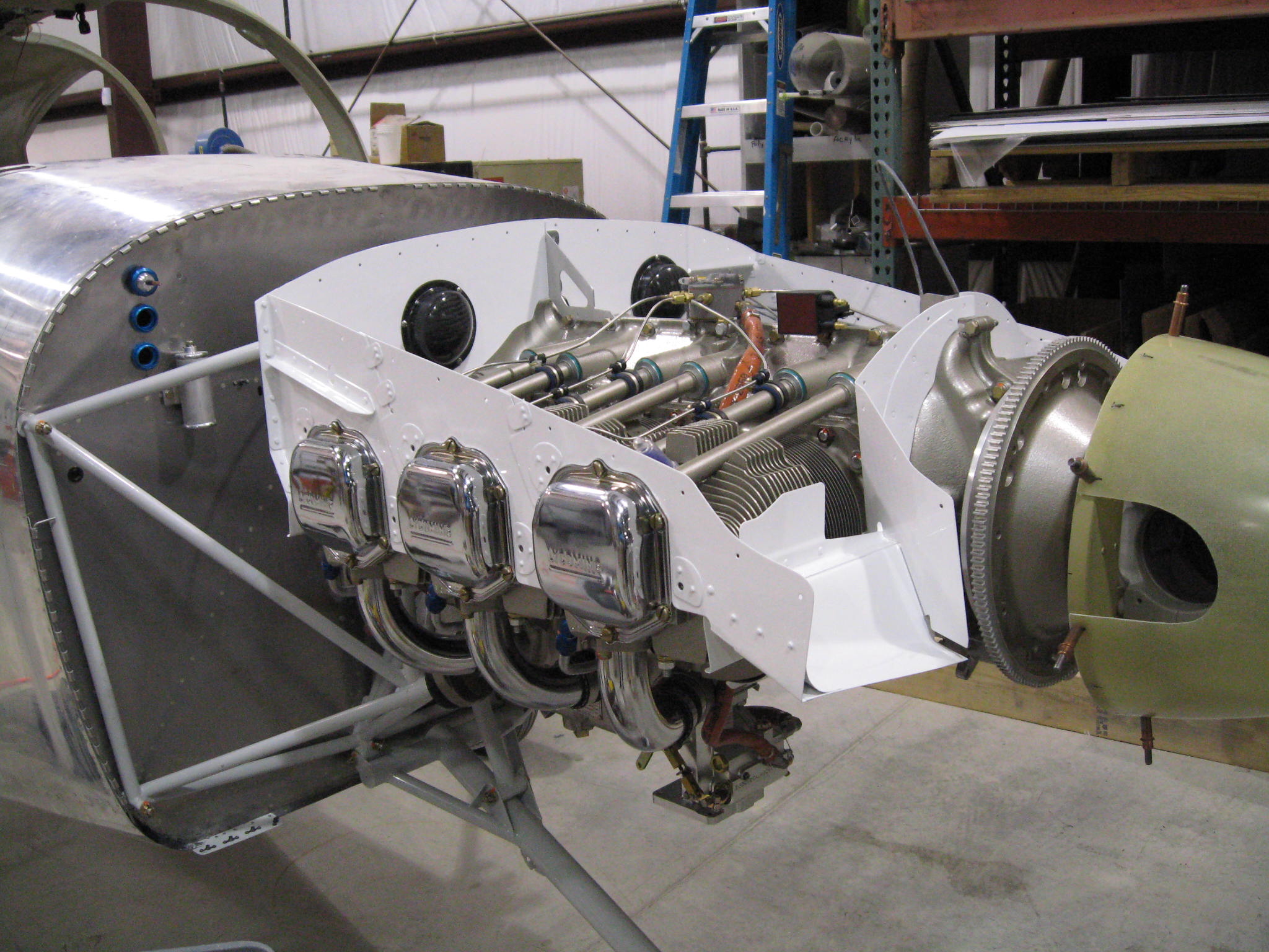

I powder coated them after they were built. Not my idea but a have seen I
few do this and they look great and seem to hold up well.

 Filesize:  452.94 KB
 Viewed:  7029 Time(s)
