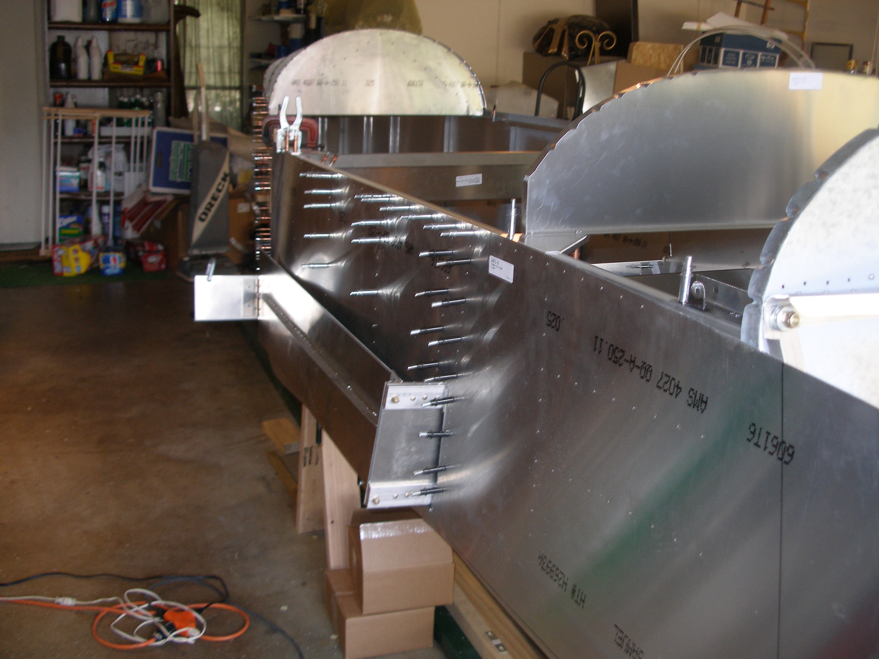

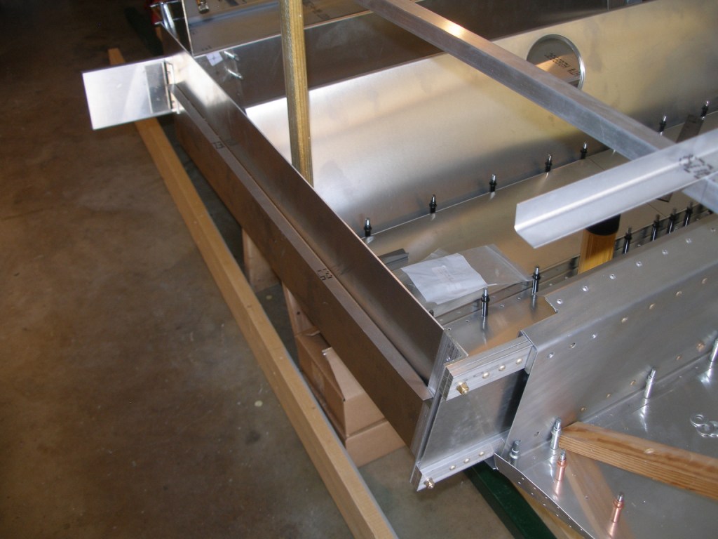

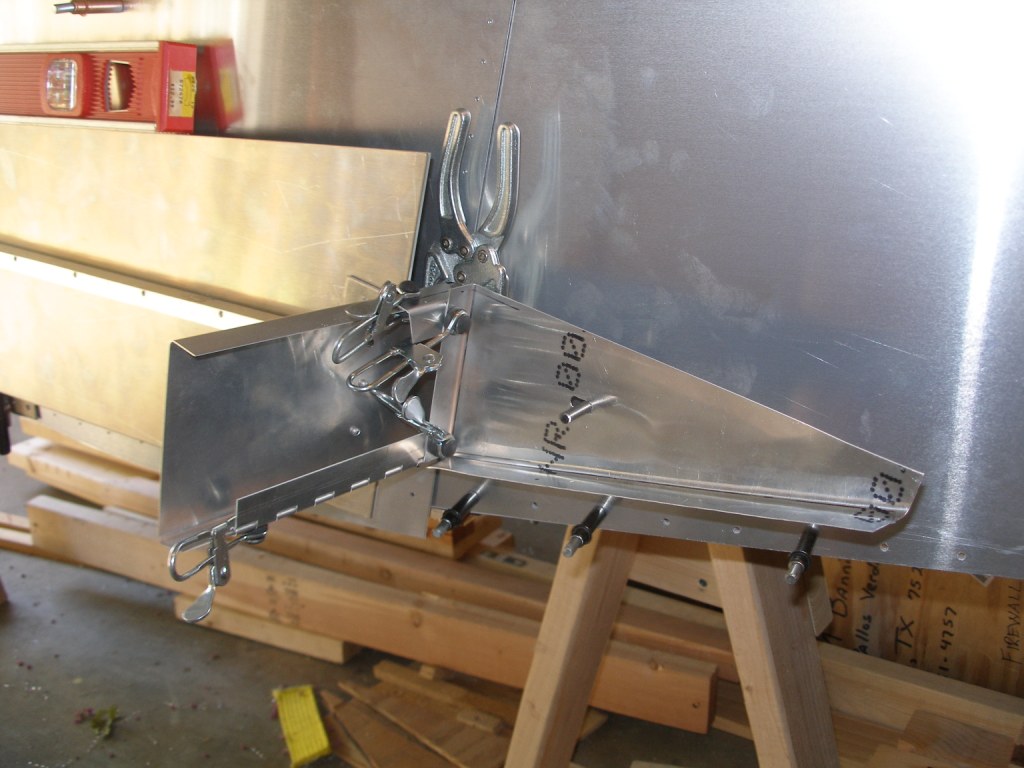

PostPosted: Sun Aug 09, 2009 5:36 am    Post subject: 601xl spar insert Reply with quote
Kev,
If you are talking about the spar center section jigs, I received all the parts to make them with my fuselage component kit. They are all aluminum and represent the relationship between the main wing spar and the rear wing spar. There is a short piece of wing spar that inserts into the spar center section, complete with the connecting bolt holes, and a short piece of the rear spar. The jig sets the distance, front to back and the vertical and horizontal angles. It is primarily used to accurately locate the rear spar attach plate, assist in cutting holes in the side skins and to assist with the flap actuator installation. See photos. The last photo shows a mock-up of the flap attached to the rear spar of the jig. Let me know if you have questions.

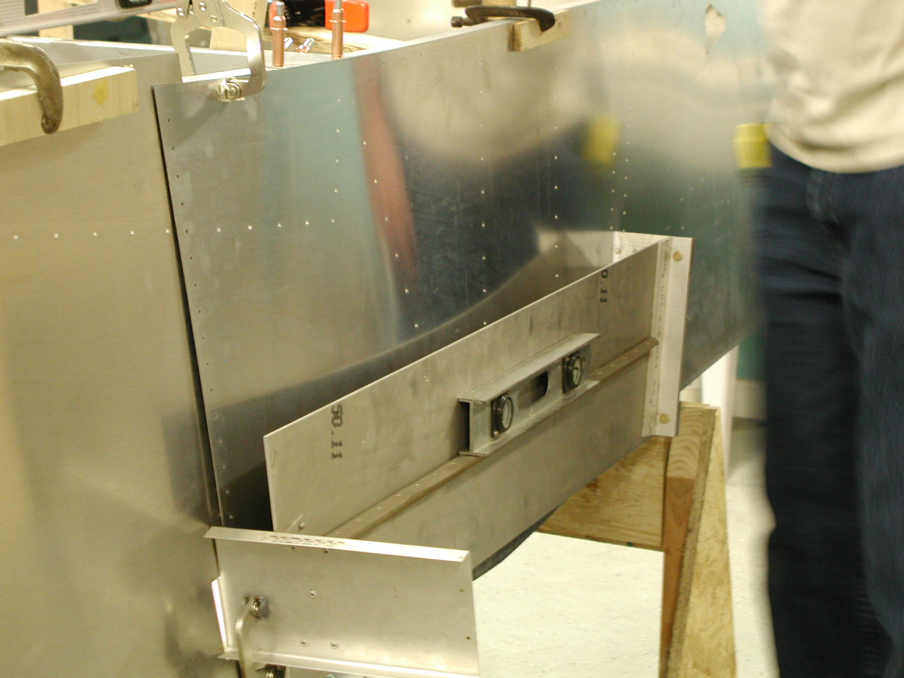

PostPosted: Sun Aug 09, 2009 10:13 pm    Post subject: Re: 601xl spar insert Reply with quote
I was wondering when this issue would come up. I hit this point in my 650 build a couple months ago. First of all I followed the plans and the drawing and made the cutout in the rear side skin to what would be the 601 design. So I have a gap in the side skin just behind the rear wing attachment. To make matters worse Zenith sent me the 601 side skins. So long story short they replaced the side skins and the top longerons. Check your seat parts and arm rest 6B18-1 aginst the drawing for dimensions. These were wrong also. The rear of the side skin should reflect the change in the wing angle. The best thing to do is borrow the wing jigs from one of out 601 brothers. I don't believe at this point that it is possible to get the rear wing attachment correct without the jigs. The picture is before I got the correct skins. Notice the gap behind the attachment point.
Its late here so I have had to keep this short. If I confused everyone I'll try to clear it up later.
