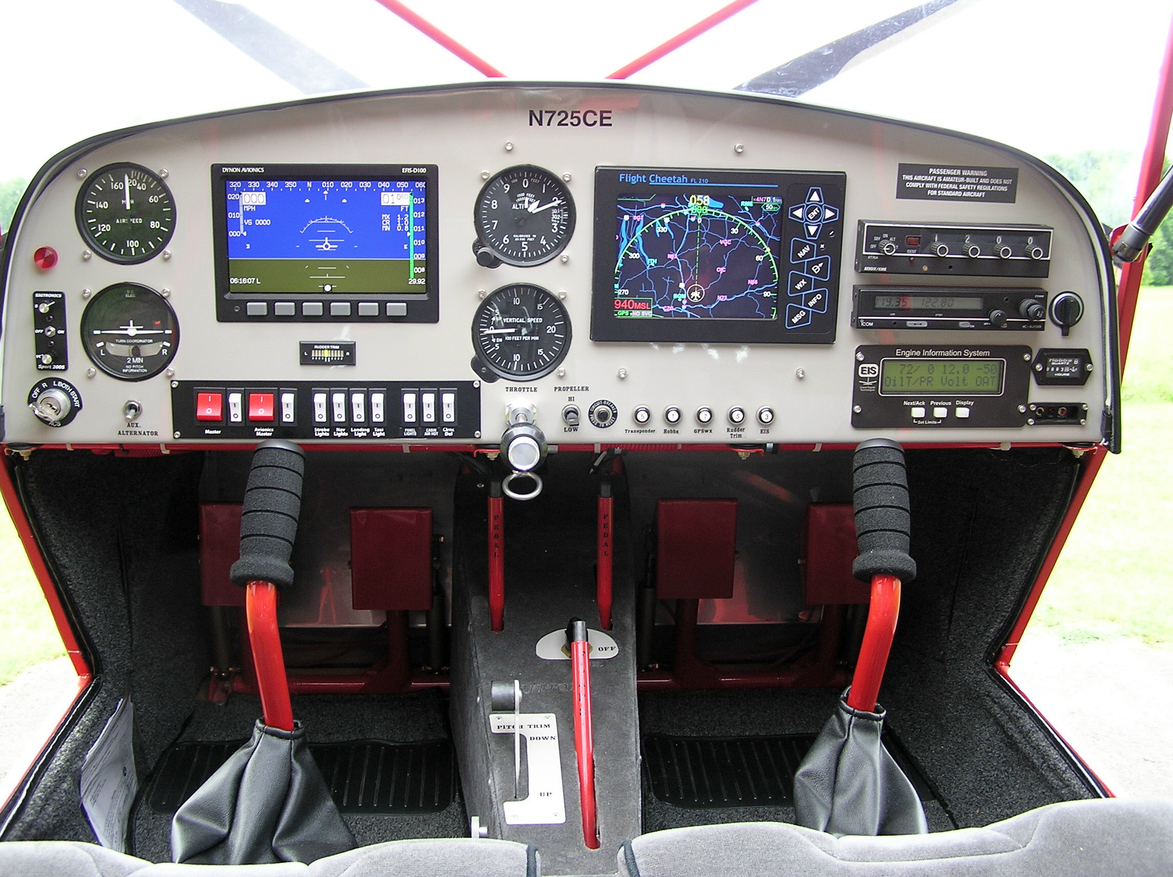

PostPosted: Sat Aug 08, 2009 6:26 pm    Post subject: EFIS Reply with quote
Lowell - I've got airspeed, altimeter, vertical speed, and an electric turn coordinator for redundancy to a Dynon D-100 in my Model 7(see attached photo) . I've got 11 hours on the airplane and find myself glancing more and more at the Dynon. It's the first airplane I've had with an EFIS and I must say I'm very impressed with it!
