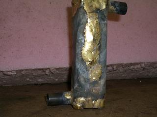

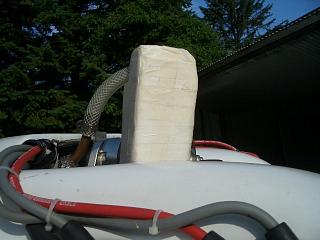

Built a separator, 5 vane 6" tall and insulated it.Last 2 hrs have collected 1"of moisture in the catch bottle but no oil.Now I can keep tabs on oil consumption.Finished a 4 vane 4" tall separator that I will install this weekend.They look weird but it's effective.I'll just keep making it smaller until it can't trap the oil.Here's a picture.

I have used oil collection bottles in race bikes, they turn up to 15 thousand RPM and oil collection is still as simple as a small plastic bottle. Oil will drop out of the vapour as long as you can slow the air down, I'm confused about the requirement for vanes and traps, are you flying inverted?

Not intentionally.On my early 2200a Jabiru requests that I run the oil level at the add mark,to reduce pushing it out the vent.The add mark is 3/16" from the end of the stick.Once it's below the stick it's hard to guess how much to add to get it back to that level,so it's been see sawing between to much and not enough with the excess ending up in the catch can.I'm just trying to eliminate the loss out of the vent so I can get a realistic handle on basic consumption.The separator just forces the vapor to make 4 or 5 90 degree turns and the oil drops out of the airstream onto the vanes and runs back into the sump.Unconfused?
