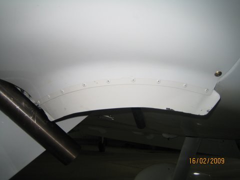

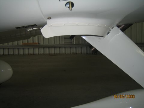

Hi Bobby
This is what improved my CHTs to no end, I now have greater than 5 inch water gauge pressure diff. from inside the air duct to inside the engine compartment (cowling). (2 pic. attached)
