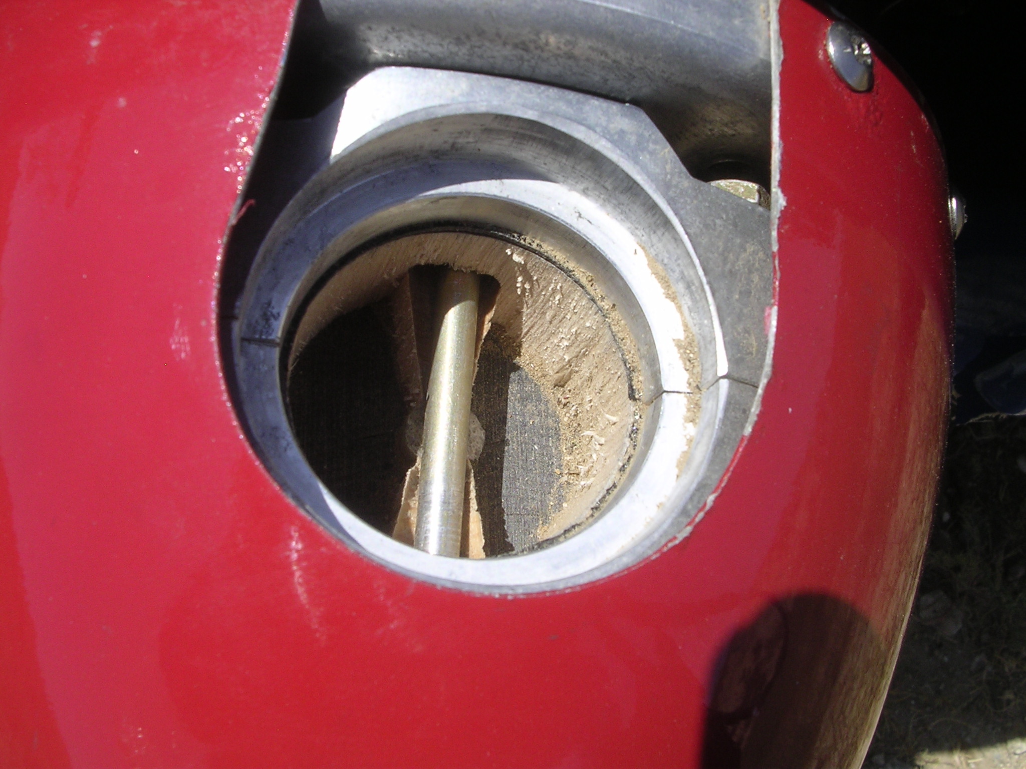

All three blades departed the airplane in straight and level cruise flight. The engine stayed in place and the Kitfox's glide performance was excellent. Unfortunately we were over a residential neighborhood and had to put it down in rough terrain. No injuries to the two occupants and no damage on the ground, but the airplane was totaled.
I will try to attach photos of the prop hub and the airplane on the ground.

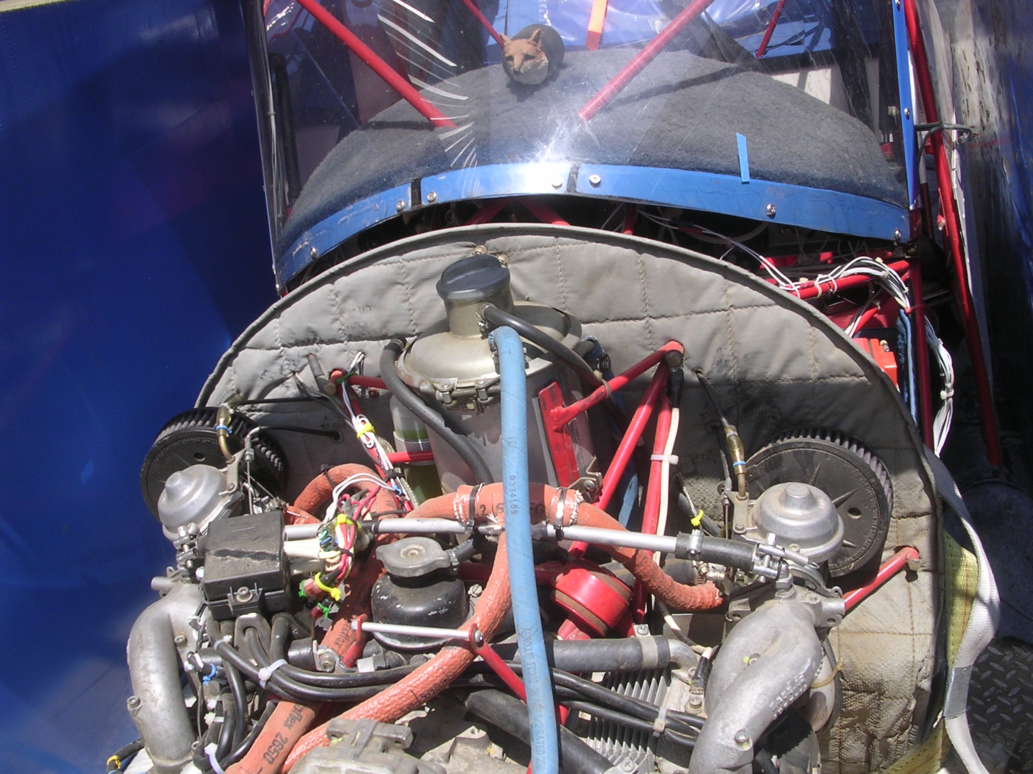

Notice that both carbs shook off at the first surge. That stopped the engine and may have kept in on the airplane.

All three blades came out clean. No broken wood, they just pulled straight out.

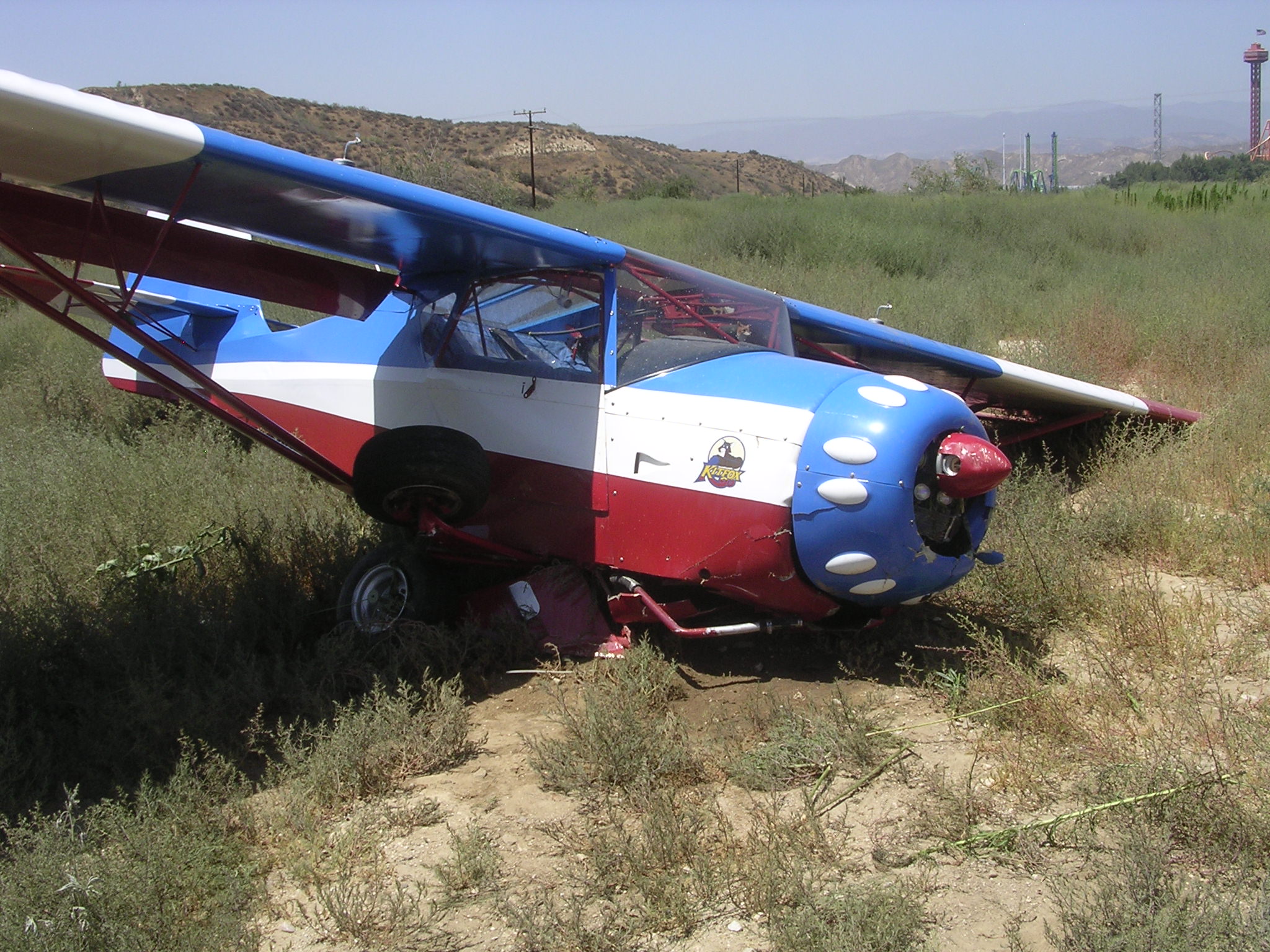

We snagged a bush and hit sideways, tearing off the gear and serously twisting the fuselage.

Jim, Sorry to read of your prop failure but glad to read you did a excellent forced approach. at first look your plane does not look too bad.
A few questions on the GSC prop, how many hours and years of service? I noticed in the pic of the prop hub that the hub halves seems to be quite close together.
They was another guy on this list a few year ago that had the same thing, not sure what even caused that one either. I have seen one blade depart but not all three at once.

The prop was 3 years old and had a about 90 hours on it. The separation between the prop hub halves was within spec at the last condition inspection.
The NTSB has the hub now, so we'll see what they think.

No we did not find the blades. We were at 2700 ft, entering a mountain pass when they departed. We did a 180 and glided 3 or 4 miles away before landing. The local police said that they had no reports of the blades coming down.
The blades would have looked brand new except that the black epoxy sleeve on the hub end stayed in the hub. They probably would have come down slowly, flat and rotating like a paint roller. I know the GPS coordinates where we were when they came off, but they could have traveled a long way on the way down.

Jim , I had a blade depart a few years ago. We took the GPS track to exactly where it departed and 3 of us spend a whole day on foot and never found anything, prop, spinner parts -- ZERO.
On the GSC - thanks for update. That is low time for a GSC. I will say the alum halves do look rather tight from that picture. Looks like possibilty of overtightening? You should have a decnet gap on those usually but with a spinner on you would have never known. The torque os only 8 foot /lbs or so. Actually I think up to 100 inch pounds ... very little .

I would think the hub halves would come together after the blades departed.
