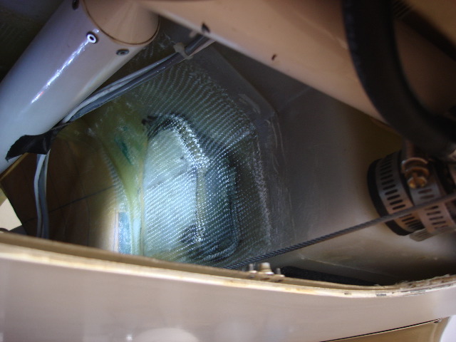

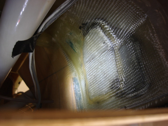

For those of you that we're wanting to hear the out come of this
subject below is a picture of the repair. I drilled the ends of the
crack. Then rubbed pro-seal into the crack as much as I could. No way
of telling how much if any went in. I then covered the area with the
gooey stuff. "Yuck what a mess". After shaping it for the angle of the
tunnel, I then placed a patch of old tank John Lawton sent me over the
crack with pro-seal on it as well. I kept pressure on it for 2 days as
it set up. Then I sanded the area with 80 grit and laid up a 6 inch, 3
layer patch of bid over the whole thing. Probably over kill but I now
have the piece of mind of knowing If the pro seal ever gave out
(Unheard of) the bid would hold till another repair or a replacement of
the tank. To hopefully help this from happening again I placed two 1
inch foam pads under the tank between the floor and the tank on both
sides. I guess as long as the tank is glassed in it can still happen
but oh well.

PostPosted: Fri Jul 24, 2009 12:44 pm    Post subject: Fuel Tanks Repaired ;o) Reply with quote
Jeff,
My compliments on a really nice job. A fix worth remembering.
Mike

kheindl(at)msn.com
PostPosted: Fri Jul 24, 2009 1:53 pm    Post subject: Fuel Tanks Repaired ;o) Reply with quote
Hi Jeff C
from the pictures i am trying to figure out how you accessed the tank. Did you make a large opening in  the bottom of the fuselage ? Normally C there are only two round access holes.

jeff(at)rmmm.net
PostPosted: Fri Jul 24, 2009 3:18 pm    Post subject: Fuel Tanks Repaired ;o) Reply with quote
Karl,
During the build which I started at Flight Crafters in 2003 we did an
oval access hole instead of the two as per the plans. Its about 12
inches across. Didn't know at the time I would ever need it but man am
I glad I did. I would think anyone at any time could make that change
fairly easily.
Jeff R.

grahamsingleton(at)btinte
JEFF ROBERTS wrote:
. Then I sanded the area with 80 grit and laid up a 6 inch, 3 layer
patch of bid over the whole thing. Probably over kill but I now have
the piece of mind of knowing If the pro seal ever gave out (Unheard
of) the bid would hold till another repair or a replacement of the tank.
Jeff R.
A258 - N128LJ / Gold Rush - Tanks Repaired and holding gas again.
Jeff
did you lay up the BID with ProSeal? I don't know if ProSeal is
available this side of the Pond. I haven't heard of it before. (learn
something every day!)
Graham
Hope you don't have any more leaks! .
jeff(at)rmmm.net
PostPosted: Fri Jul 24, 2009 3:48 pm    Post subject: Fuel Tanks Repaired ;o) Reply with quote
Grahm,
The pro-seal can be found on this page.
http://www.aircraftspruce.com/search/search.php
No I laid up the bid ontop of the pro-seal patch after it was cured. It
is used to seal fuel tanks of any kind.
Jeff R.

kheindl(at)msn.com
PostPosted: Fri Jul 24, 2009 5:23 pm    Post subject: Fuel Tanks Repaired ;o) Reply with quote
Jeff C
I thought that is what you did C and i wish this would be an approved mod. my only concern would be: does it not weaken the fuselage ? i would love to have a similar hatch at the tail.
Karl

jeff(at)rmmm.net
PostPosted: Fri Jul 24, 2009 8:15 pm    Post subject: Fuel Tanks Repaired ;o) Reply with quote
On Jul 24, 2009, at 8:21 PM, Karl Heindl wrote:
Jeff,
I thought that is what you did, and i wish this would be an approved
Karl,
Im not an engineer but I fly off a grass strip thats not so smooth and
I guess my bird is still strong. Maybe thats why the tank was stressed
but until now my Tri-Gear has been great on all the bumps. I would say
the larger hole is fine.
I believe most of the planes that we're started at the build center at
the time / "Flight Crafters" we're done this way but I'm not sure.
Jeff R

> On Jul 24, 2009, at 4:40 PM, Karl Heindl wrote:
> > Hi Jeff,
> > Normally, there are only two round access holes.
> > Karl
> > To: europa-list(at)matronics.com
> > From: jeff(at)rmmm.net
> > Subject: Fuel Tanks Repaired ;o)
> > Date: Fri, 24 Jul 2009 13:24:32 -0500
way
the
> > the tunnel, I then placed a patch of old tank John Lawton sent me
over
> > the crack with pro-seal on it as well. I kept pressure on it for 2
> > days as it set up. Then I sanded the area with 80 grit and laid up
a 6
> > inch, 3 layer patch of bid over the whole thing. Probably over kill
> > but I now have the piece of mind of knowing If the pro seal ever
gave
> > out (Unheard of) the bid would hold till another repair or a
> > replacement of the tank. To hopefully help this from happening
again I
> > placed two 1 inch foam pads under the tank between the floor and
the
> > tank on both sides.  I guess as long as the tank is glassed in it
can
> > still happen but oh well.
> > Anyway one other quick question to anyone. My 912-S has been,
> > apparently running a little rich.   The mixture screw on the carbs
has
> > been at the 1.5 reverse turn recommended by rotax since new. Can
> > anyone share where there mixture/screw works best. Or is it just a
> > setting we should do at balancing the carbs? Any help would be
> > appreciated for this non mechanical type person.   ;o)
> > Best Regards,
> > Jeff R.

Jeff,
I am very glad you literally got the fix in!
I also have the larger fuel system access hatch thanks to Russell.

JEFF ROBERTS wrote:
Grahm,
It is used to seal fuel tanks of any kind.
Jeff R.
