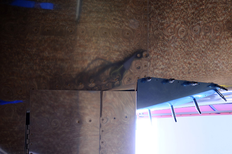

Dear Listers,
Please see the attached photo taken from the underside of my RV-8. I was going to cut the bottom flap skin to match the diagonal of the fuselage skin per the "View E-E Flaps Fairing" on DGW 80. But, it appears that the aft portion of the flap skin was cut too short by the QB builders. Note that the front part seems to be exactly the right length and that diagonal cut will clip just perfectly. But on the aft skin of the flap, it is cut off about 2" too short to continue the diagonal line. Since the fuselage side skin is curving up right there, this will act like a giant air scoop. The flaps appear to be mounted in the correct position, left/right as they are the required 3/16" from the ailerons.
The left side is exactly the same as the right side as shown in the picture.
Thoughts?

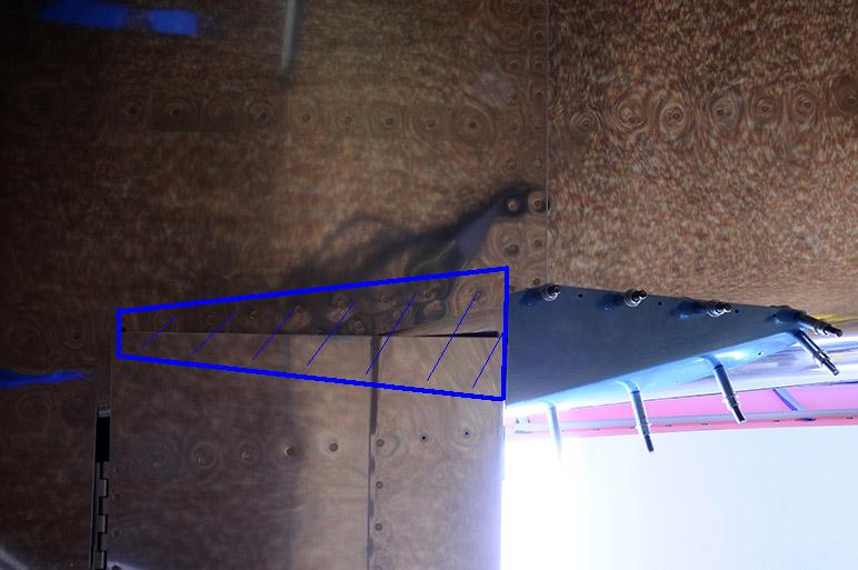

Here's what I heard back from Van's today regarding the issue including the updated picture:
Simply rivet on a .040" extension (like the -4 & -6 builders had to) as shown in the attached picture. You can bend it to fit any contour or overlap the flap intersection fairing as you see fit. Use pop or solid flush rivets to attach.
Um, good thing its underneath... Wink
Matt

Matt,
That's not the solution I would have expected to hear. You are way ahead of me right now. I am about to rivet my flaps together and I'm doing a standard kit. When I saw your 1st pics, I thought the skins looked to be cut about the same as mine. After seeing what Van's suggested you do, I went out to measure my skins. From the first rivet out to the inboard edge of the skin, I measure 3-7/8". The last rivet toward the aft end of the flap measures about 2-7/8" to the edge. Is this what yours measures? Just thinking out loud here, if you splice an additional skin extension to the existing flap skin as you have it drawn, wouldn't the shop head of the rivets contact the bottom of the fuselage thereby keeping the flap skin from resting flat against the fuselage?
Bill Settle
