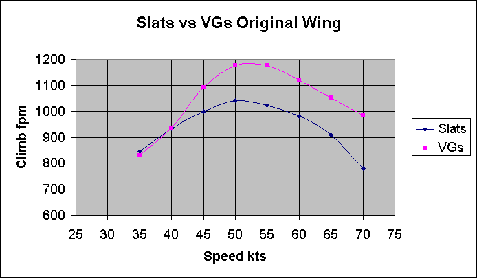

You got the earliest Stolspeed VGs.  Since then they've been considerably strengthened.  I'll send you replacements, no charge.  Anyone else with the early Stolspeed VGs that have broken, let me know and I'll replace them with the newer ones, no charge.

I put JG's VG's on the tail and yes, they really do work! Fantastic, as a matter of fact.
Next project is to pick a nice day and run all my V speeds with and without the slats, and then with the wing VG's. It will be interesting to see what I find out. Unfortunately my plane is not painted yet so I might have to put them on, then take them off for painting, then back on again. Oh well, I love to tinker anyway....
Hope to meet some of you guys in Oshkosh. I wonder if there is some way of identifying the guys on Matronics who will undoubtedly be hanging around the Zenith Display - everybody wear some wierd bit of clothing, a particular hat or something simple so Joe builder could say "Hey, there's a guy with an A5 rivet through his left ear and a silver cleco through the right side of his nose so he must be one of those reprobates on the Matronics 701/801 group - I'd better go meet him!" LOL

Can anyone give their opinion on the difference between the STOLSpeed and Zenith VGs as far as the tail feathers are concerned?

Just a tip for mounting the VGs temporarily.  Just use a 3/8" strip of adhesive and place the VGs across it side by side and then cut between them.  Much easier than cutting all around each, and still plenty of holding power for testing. Have fun tinkering.
JG

That is very nice of John G. at Stolspeed to offer to replace broken VGs.
I have them on my 701( no slats) and they perform excellent. I wouldn't go back to slats on a bet. It's just a much easier plane to fly.

Jay, check out John Gilpin's (JG) website, www.stolspeed.com With all due respect to JG, keep in mind that he is selling something when you read his site.
Essentially, by removing the slats from the 701 you are reducing the size of the wing (we are not talking VGs yet). The higher loaded wing will fly faster because of less drag. You also loose a good amount of the STOL capcability of the wing.
To fix this loss of low end STOL performance, you install vortex generators on the wing. This returns most (but not all) of the STOL capability but leaves the higher top speed alone. Now the question that everyone has to answer for themselves is, is the increase in top speed worth the minor degridation of the STOL capability. The consensus of those that have made the change is that the very minor loss of STOL capability is very acceptible because the 701 has so much STOL ability to begin with. What is another ten feet of take off roll when you are still getting up faster than almost any other aircraft out there.
To answer your other question, there is no advantage to using VGs and slats. They accomplish the same goal of keeping the airflow attached to the wing at higher angles of attack.
While the above information may sound like I am firmly in the VG side of the debate, I actually am planning on installing my slats. I just like to look at both sides of an issue.

Sorry Jay, I missed mentioning the elevator VGs on my post last night. The purpose of the VGs on the elevator is to keep the airflow attached at high elevator angles of attack. On the elevator, this is during the flare for landing. The VGs are installed in such a way that they do not actually see the airflow duing straight and level flight. As the stick is pulled back during the flare, the nose of the elevator drops down into the airstream and the installed VGs then keep the airflow attached to the skin of the elevator. This essentially gives far better elevator control during the flare.
Essentially, what I am saying is that VGs on the elevator have nothing to do with the VGs on the wings so therefore, it is quite acceptible to use both. I plan on using the slats on the wings and VGs on the elevator.

JG from Stolspeed chipping in here.  I'm still around and still testing and comparing STOL wings.  Whenever I hear claims and statements I just have to do tests to see if they stand up.  I'm a curious experimenter first and foremost.  I started out very sceptical of VGs, but curiousity led me to try them, and the results led to manufacturing them.  Since so many of you out there are sceptics, it's a small business, and pretty much just supports further work in experimenting and testing.  The results often disprove commonly held opinions and open new possibilities, which is really exciting and worthwhile for an experimental engineering type like me.  This is what drives me to do this work, not the business of selling VGs.  I'm no salesman, just an enthusiast.  I'm retired with enough to get by, and this business is just a means to support all the research.  Some of the results of that research has already been very useful to others who are open to change.
I've just finished another round of extensive testing of a Savannah with slats, without slats, and with their 'VG' leading edge, and further tests loaded with sand bags to max gross weight.  Many hours of climb at full power for 1000 ft, followed by engine off prop-stopped glide back down the 1000 ft, timed with a stopwatch, over a range of speeds from 40 to 70 kts.  Have to do it all at sunrise to avoid thermal activity, and do several runs at each speed to eliminate spurious readings.  It gets tedious, but the results are enlightening and useful. I used several hundred dollars of fuel, and a lot of hard work for the engine, just on this last series....   I just finished that work yesterday, so it's going to take a little awhile to analyse and compile all the data, then I'll write it up and publish for all to use to make your own decisions.  This was done on a Savannah, but identical airfoil to the 701, so the results are very useful.  I'll let you know when it's ready.
Some of the prelimary results are ready, and attached is a graph of the climb rates for Slats vs VGs.  Note that the climb rates for each version below 40 kts are pretty much the same, so the Angle of Climb will be pretty much the same, contrary to claims elsewhere.  Above 40 kts the difference is really significant.  These are real life results not just claims, so take what you will from them....   More to come later.
JG
