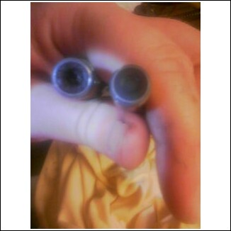

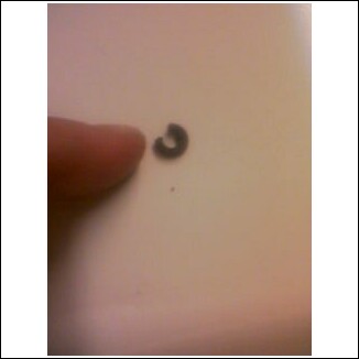

cristalclear13
Joined: 19 Sep 2007
Posts: 363
Location: Southeast Georgia
PostPosted: Thu Sep 03, 2009 6:42 pm    Post subject: Re: EGT quirk Reply with quote
beauford wrote:
Miss Cristal:
One other thing you might consider checking on the carb which is
running rich is the enrichment or
"choke" piston. If this little piston is not fully seating due to
misadjusted cable, crud in
the seat, or deteriorated rubber seal in the base of the piston, it
can easily produce the
symptoms you describe. A small leak in the enrichment circuit can
produce substantial effects.
Worth what ye paid fer it...
beauford
FF-076
Brandon, FL
Beauford, This advice was worth MUCH more than what I paid fer it! Thank you! I also thank Ronnie Smith at MSLA because as soon as I told him my most recent symptoms (advancing the throttle and no or very poor response), he mentioned it seemed to be running too rich for the altitude. He first suggested changing the idle jet. So I was actually taking my carbs off to see what size jets I had when I discovered that choke seal on my front carb was totally deteriorated. See the pics.

 Viewed:  13638 Time(s)
 Filesize:  18.22 KB
Cristal Waters
