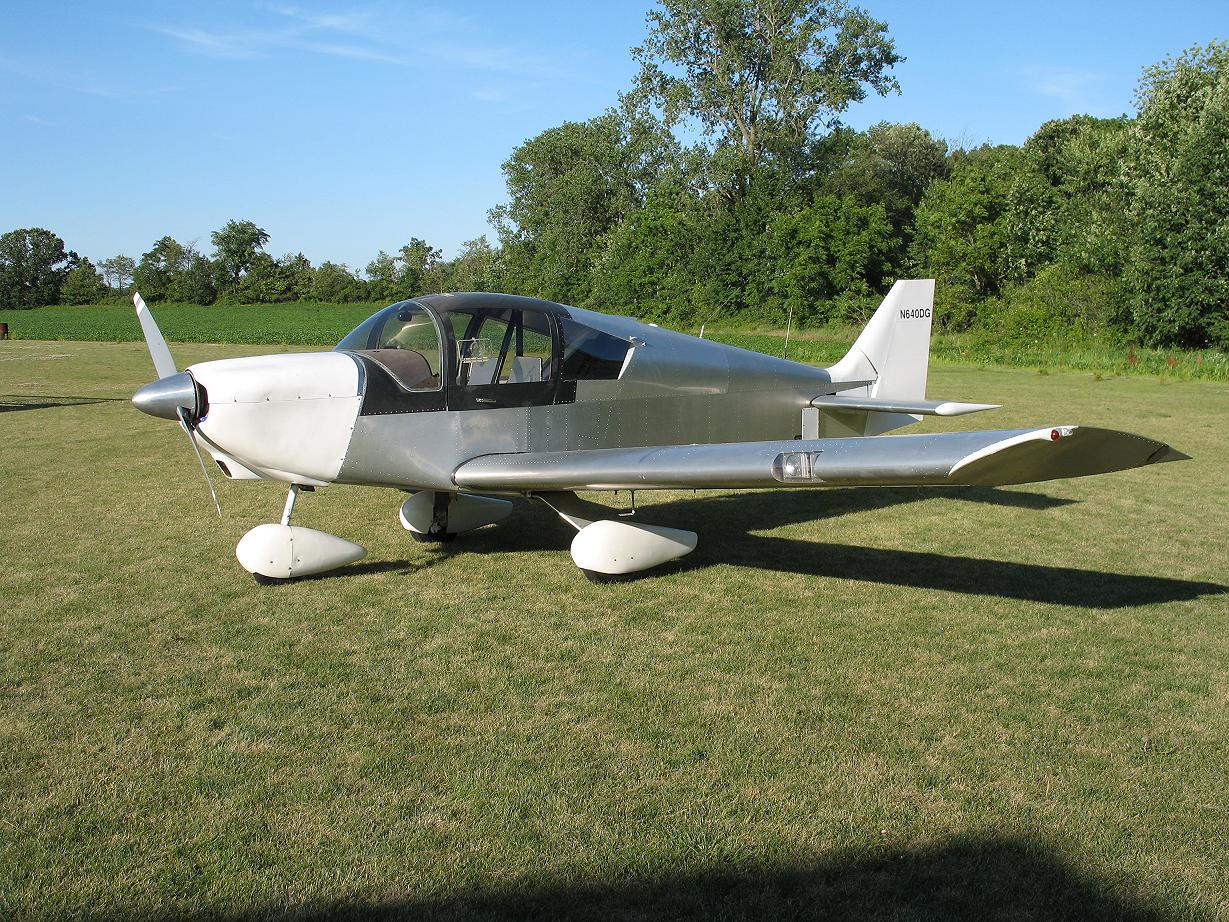

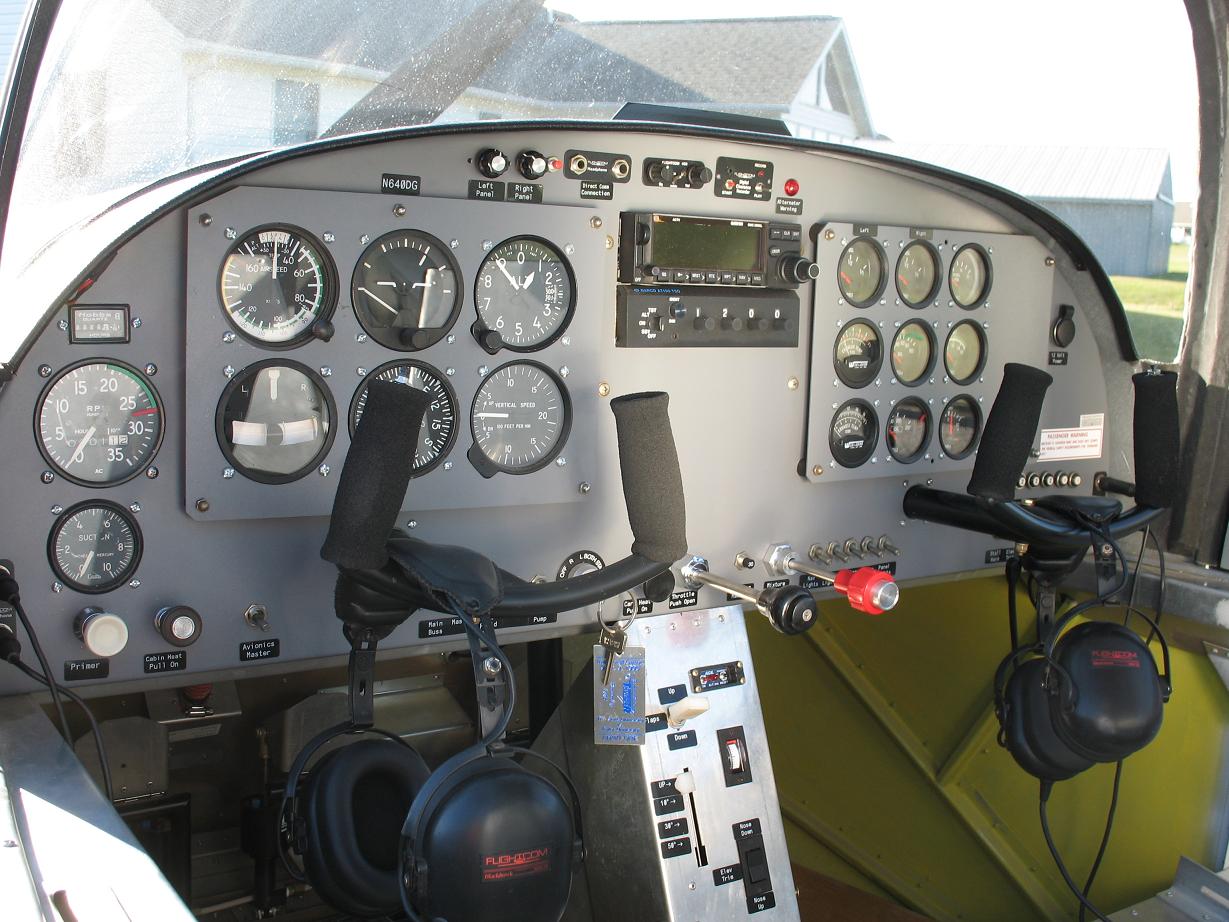

Here's some inspiration for those building or prospective builders (Jeff).
This is my ready for sign off CH640, 7 years in the making(pictures taken
this evening). Lycoming O-340, steam gages, Garmin 250XL GPS/Comm. For you
guys flying already, any flight characteristics, speeds, etc. would be
appreciated.

I like it!! Have you thought about paint or polish?

Congratulations Doug, nicely done!

I'm going to paint it or have it painted after Phase 1 is complete. I painted the rudder to have a place to put the N-numbers and realized I'm not all that great with a spray gun. I'll probably fly it to an aircraft paint shop.

Congratulations, Doug! It looks great.

First of all, nice job. It gives me inspiration to see other guys completing their projects! I was looking at your cockpit picture and saw that you have electric trim and flap control. What did you use, or recommend that I use to upgrade to that as well? Was it easy to switch over from the manual set-up that is included in the kit? I want to add an autopilot (just the basics, nothing crazy) and think electric control of the trim and flaps would lend itself nicely to that. I just got my wing kit and am trying to plan ahead a bit.

The trim uses a Ray Allen Company servo to move the trim tab. The switch and indicator are also Ray Allen. It all came as part of my kit. After looking at the manual trim drawings I'm sure that the electric trim is much easier to install. The electric flaps were also part of the controls kit. I think you would want to specify these options when you order your fuselage kit. I can get some pictures if you would like.

Sorry, I was really referring to the electric trim you added. I had a brain fart and forgot that the flap control comes standard as electric with the kit. You said the trim came as electric with your kit? Mine didn't. I just wanted to get rid of the trim wheel and get electric on that as well. If you get the time, some pics would be great.

Doug - Congratulations and nice job on your plane. It looks great. You will love how it flies. As far as speeds, here are a few ballpark numbers and tips for you first flight. Obviously, these numbers are in my plane, so until you verify your ASI accuracy etc, please don't take them as hard numbers for your airplane. Flying solo it accelerates quickly on the runway. Until you find the best setting for you, set the elevator trim in a neutral position initially. This will require some back pressure on the yoke to get the nose wheel off the ground at about 55 kts, it will then fly itself off shortly after. Vx is 65 kts and Vy is 74 kts in my plane. Stall clean is 48 KIAS and with flaps is 42 KIAS. For landing, I pull power back to 1500 abeam the numbers, put in 10 of flaps, slow to 80 KTS on base with 20-30 of flaps, 70 kts on final and 65 kts over the fence with full flaps. If you have the runway length available, you can probably come in a bit faster until you are comfortable with it's slow flight handling characteristics. It can be tough to keep the nosewheel up after the mains touch, but this is usually because you land a bit fast. There are really no quirky flight characteristics. Have fun and be careful.

I have the manual elevator trim, which I like. The trim wheel mechanism seems a bit complicated, but is really not that difficult to assemble, and has worked flawlessly so far (700 hrs).

Personally, I like the manual trim. I actually have the servo for the electric trim because they actually sent my kit with the trim bellcrank set up for electric trim with the servo installed. I took it off and went with the manual trim and have no regrets. I'm sure either way works fine so go with whatever you are comfortable with.

Doug, great job. It makes me so happy to start seeing some more 640s come to life. It seems like forever that we've only had the same 3 airframes in the US. (Zenith's N640Z, Jeff Paden's, and Steve Adams')
If you need any help coming up with a paint scheme let me know. I enjoy helping people out for free.
