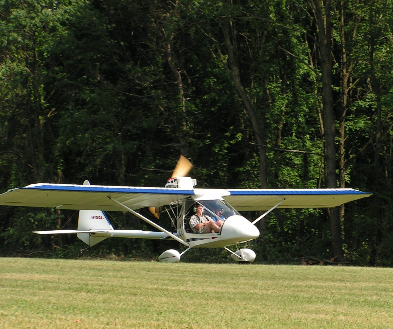

PostPosted: Sun Jul 05, 2009 3:10 am    Post subject: oil Usage Reply with quote
Lynn
It,s a pusher,the rear of the engine is covered by a molded fairing that smooths airflow into the cooling shrouds.I have only one picture on the computer to send but maybe it will show enough to explain the set-up
G,Aman

Lynn Matteson
Posts: 2778
PostPosted: Sun Jul 05, 2009 9:37 am    Post subject: oil Usage Reply with quote
Gary-
I guess I'd have to see where the oil collection bottle is in
reference to the airflow to know if it seemed right for your
installation. However, someone with the same setup might chime in and
help you out. I just re-read your original post, and I'm not sure if
you're indicating a problem or not. If all the expelled oil ends up
in the bottle, that seems right to me, unless you think TOO much oil
is being expelled by the engine. Just keep in mind that if the vent
overboard is in a high airflow area, maybe a vacuum is being formed
and helping to draw oil out of the engine.
