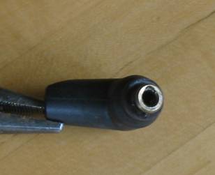

Just want to pass this onto you 912 and 912S drivers.
I was flying with a friend and after take off at an away airport, we were at about 400 ft and my 912S developed a little miss. Pulling the power back a bit stopped it, but when I went back to full power, there it was again. We went back down but couldn't duplicate it on the ground. Took off and again and at about 400 ft there it was again. We left it at that airport for a few days rather than fly home over the mountains.
A few days later, I replaced the plugs - It had been 220 hours any way - and they all looked good. I did notice that the cap on the bottom plug on the #2 cylinder was loose. I was hoping that that was it. A test flight showed no problem, so I flew it home.
A couple of weeks later, I was taking a friend up, and at about 400 ft above the ground there it was again. A real careful check showed the cap on the bottom plug on the #2 cylinder was real loose and the top cap, while not a loose as the bottom one, was looser than all the others.
I decided two new caps were in needed. They are like $55 each from Lockwood. Wow!
The picture is the old bottom cap with the rubber insulation cut off. It has a lot of wear making the hole elliptical.
I am hoping I have the problem solved. But have some questions:
Why the #2 cylinder?
Why both caps on this cylinder?
Has anyone else observed this problem?
Why would the cap wear like this?
Why are the spark plug caps for the 912S so expensive? The plugs for the 582 are more reasonable at a few bucks each. ???
Is there something weird with my installation that causes the vibration problem at that cylinder?
Randy - With shaken faith in my "bullet proof" 912S
Model 5/7 WarpDrive taper tip prop.
 Filesize:  6.77 KB
 Viewed:  3232 Time(s)
Randy
Kitfox 5/7 912S
Black Hills, South Dakota
mlpaton2000(at)yahoo.com
