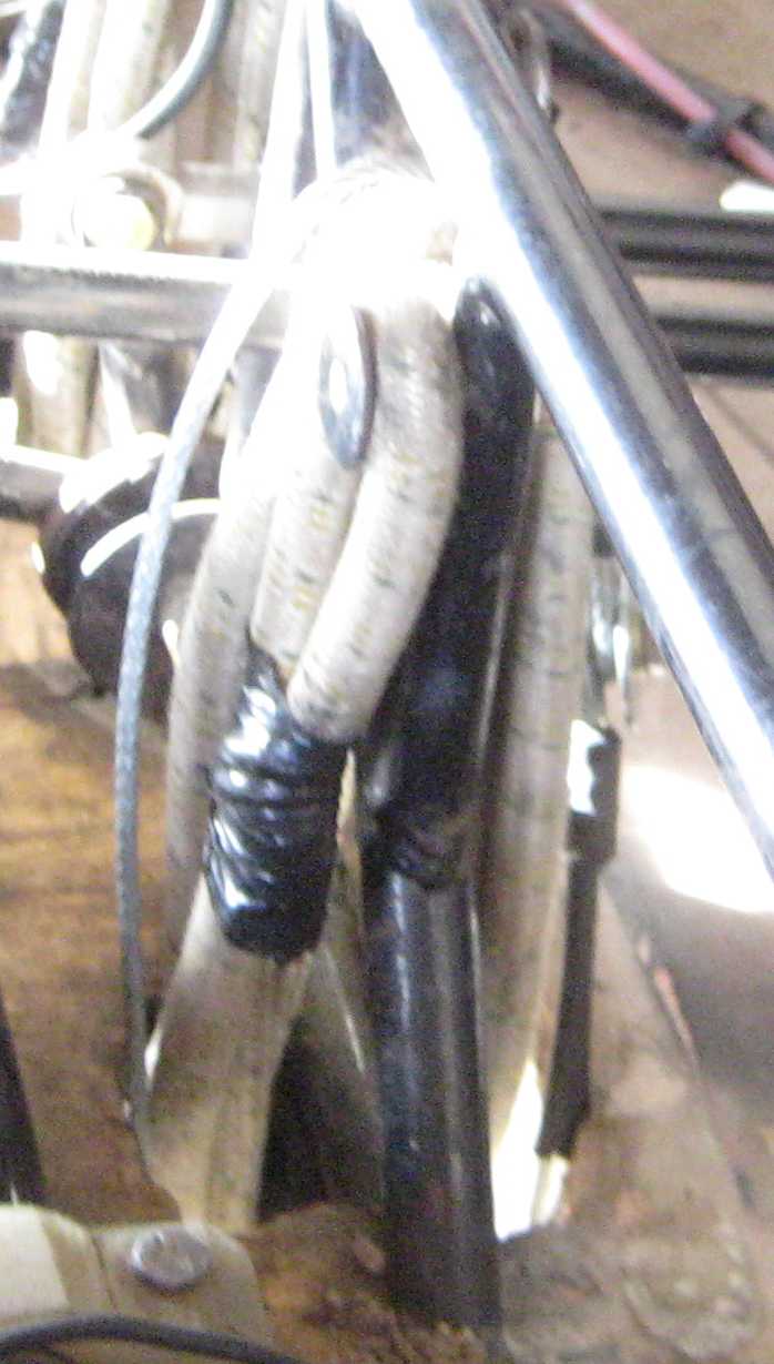

dave
Joined: 22 Sep 2006
Posts: 1382
PostPosted: Sat Jun 27, 2009 2:00 am    Post subject: Re: HighWing Bungees Reply with quote
I looked but have no pics of crimping the bungees.
Here is a finished one with tape on it . I was out of heat shrink at that time.
Dave
