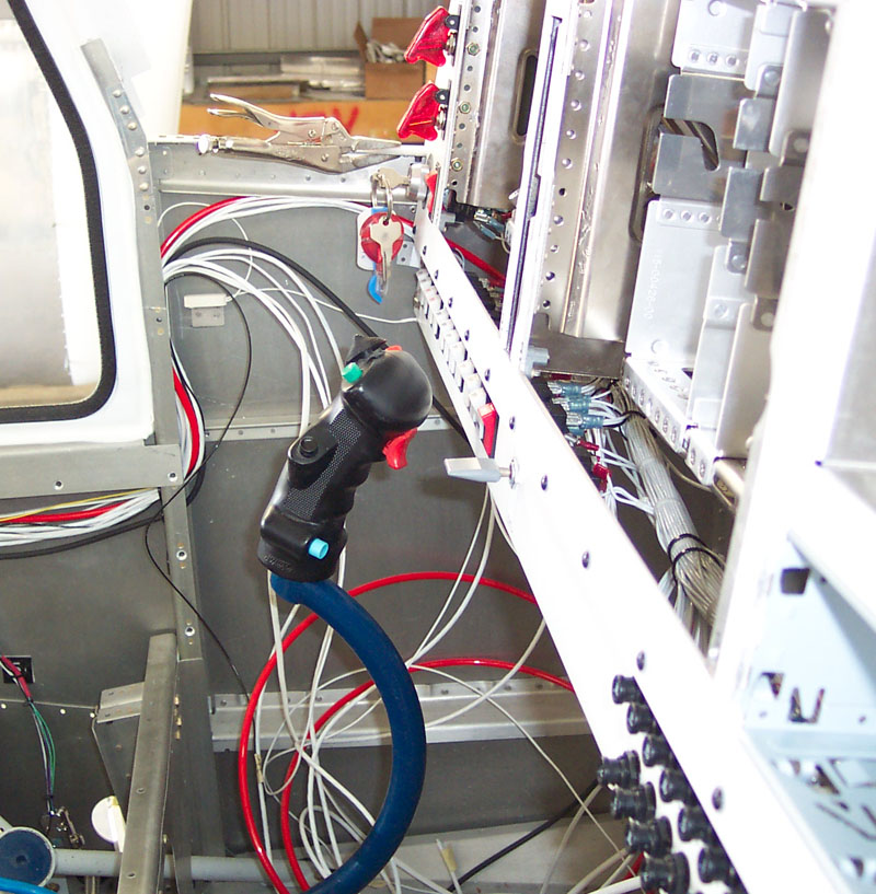

I am using the CH grips. I adjusted the elevator travel prior to installing the grips. Installing the grips required cutting the vertical portion of the stick off as far down as possible then mounting the CH grips. I also have a row of toggle switches across the stock Vans panel support.My sticks do contact the switches when pushed forward. I will say that in 75 hours of flight, I have never even been anywhere close to the panel with the stick. I am happy with the height of the sticks and the position at neutral. I do get full up elevator and roll deflection.I think the only way to solve the "Problem" is to make new metal control sticks or rebend the existing ones. I could do this but so far have resisted trying to fix this. I know that bumping the switches with the stick could be a problem but as long as it does not jam anything, I think I am ok it the way it is.Now someone else on this forum may raise a valid reason for fixing the problem but I like the current stick positions relative to my seated position. I tend to fly the airplane with my hand resting on my leg and just using my finger tips at the base of the stick for control. (Hold comments - Please!) but it works well for me.I think that if you had that much forward stick in flight something pretty wild is going on and you will be having other issues to contend with.Just MY Opinion.Jim CombsN312FDo Not Archive --> RV10-List message posted by: "Walt Fuller" <w_fuller1(at)verizon.net>Hello all, My name is Walt Fuller and I am a new member of this forum.My father (capt. delta retired, 757-767 ) and I are currentlyin the final year of construction of one of Van's RV 10homebuilts. My father optedto install modified sick grips complete with trim controls, autopilot, combuttons. The specs call for 30 degrees of up elevator and 25 degrees down.We "zeroed" the calibration tool and found that the 30 degree up elevatorwas right on the money. However, the stick grips bottomed out on theinstrument panel when full forward stick was applied, with only about 20degrees of down elevator. With the airflow controls pulled fully out (alternate air, etc.), we got less than 18 degrees of down elevator!We attempted to make some adjustments to the eye bolts between thetorque tubes and gained some down elevator but lost the up elevator.Even with the stick grips off, the sticks still hit the airflow controlsbeforethe 25 degree down was reached. I think our only option is to cut thesticks down to allow the top of the grips to pass under the panel. Hasanyone else run into this scenario and is there an adjustment that can bemade? Thank you for your response.p.s. We built, flew, and sold one of Van's rv 4's back in the late '80's -early '90's ..N52FK A very fun airplane!Read this topic online here:http://forums.matronics.com/viewtopic.php?p 49364#249364 [quote][b]

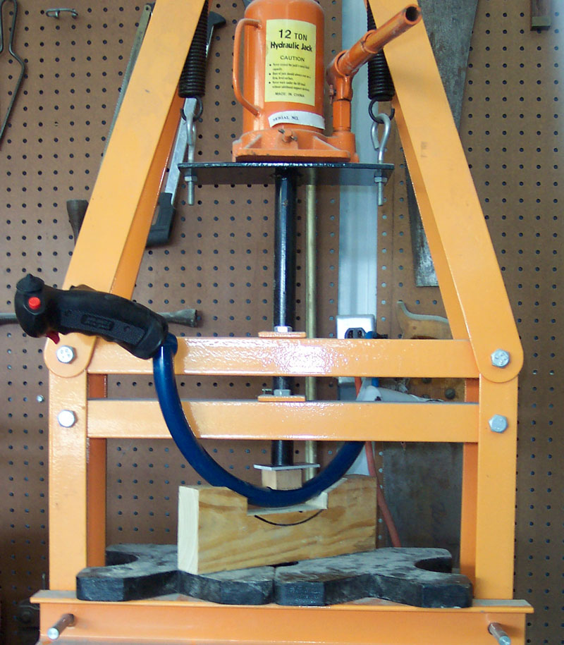

This is a common issue and our solution after adding large head infinity
grips and a custom panel was to bend both sticks in a press to add a
touch more curvature. This was surprisingly simple and we were able to
completely clear all obstructions w/o changing the feel of the control
in ones hand. The one downside is our stick turned completely blue.
Robin

Riobin,I like the method you have for changing the bend in the stick.Have to think now about maybe fixing mine.Jim CN312FDo Not Archive [quote][b]

Thank you All very much for the input...Robin1: We discussed bending the sticks as well, but were concerned with inadvertently "crimping" the insulation which covers the wires running through the stick...which was a real "Bear" to feed through. After consideration, we temporarily installed the left seat and found we too could rest the arm on the leg and comfortably touch the stick grip. The decision was made to carefully cut the top of the sticks down as far as practical. We used a pipe cutter, then a ban saw with a make-shift spacer to protect the insulation. We now get full forward stick, only slightly touching the pullout controls when they are full out.

we had a similar occurance on RV-10, kit #203: the co-pilot side rubbed the aluminum piece below the panel and we want to put some switches or circuit breakers there so opted to tighten the bend on the curve of the stick. That steel is some pretty stubborn stuff (probably chrome moly) so we strapped it tightly into a bender and let it sit overnight - no joy. Next we strapped it into the bender and heated it to a light cherry glow and let it cool for an hour - eureka. We got our clearance and all is well. Apparantly, the QC is a bit lax on these - our two control sticks differed by about 1.5" clearance measure from the panel with oak wooden grips installed.

I actually did get the controls installed and all the linkages correct with the vans sticks clearing everything. The stick grips have a slight forward cant to them (makes them more comfortable to hold). Its the forward cant that caused the problem. I will be checking them again to see what I need to do to get the stick with grips to clear the switches. I don't want the grips to be vertical and I like the current stick position for normal flight. Making them lower to clear the panel is not desirable either. Have to take another look at what I have and what changes can be made.Thanks, Jim CN312F - Flying 75 hours.Do Not Archive. [quote][b]
