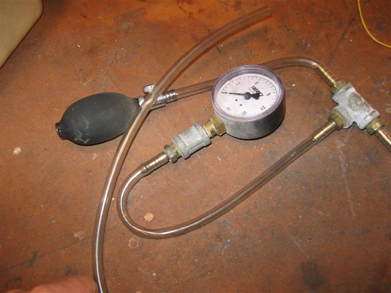

PostPosted: Thu Nov 26, 2009 12:03 pm    Post subject: 582 egt mismatch Reply with quote
My guess is that you have an air leak C probably from a leaking seal.  One way to test for air leaks is to preasure test your engine.  Basicly C what it amounts to is you seal off the intake and exhaust manifolds so they can't leak air C and then pump 5 lbs of air into the crankcase.  The engine should be able to hold air for a while.  Quoting from the article in Ultralight Flying Nov. 1986 that discussed this procedure C "a perfectly sealed engine will hold preasure overnight.  Most engines will leak a little C perhaps losing 1 to 2 PSi in a 5 minute period".  If you want C I could send you the article.  It is easy to make a tester C some 1/4" plastic line C a T C a low preasure air gauge C and a bloodpreasure tester bulb to pump the air up and the valve it has to hold the air in.  The air is pumped in through the pulse line port for the fuel pump.  Take care C  Jim Chuk

PostPosted: Thu Nov 26, 2009 3:01 pm    Post subject: Re: 582 egt mismatch Reply with quote
Hi
Will pressurizing the crankcase thru the pump pulse port only pressurise the rear half of the crankcase?

thesupe(at)hotmail.com
PostPosted: Thu Nov 26, 2009 6:06 pm    Post subject: 582 egt mismatch Reply with quote
Yes if the seal between the two sides on the crank holds.  There should be a port on the front half of the crankcase also.  On second thought C I can't say that for sure on the 582 C I know there is a port on front and rear of a 447.  You could plug the pulse port and put fittings in the intake plugs and pump the air in there.  Jim Chuk
