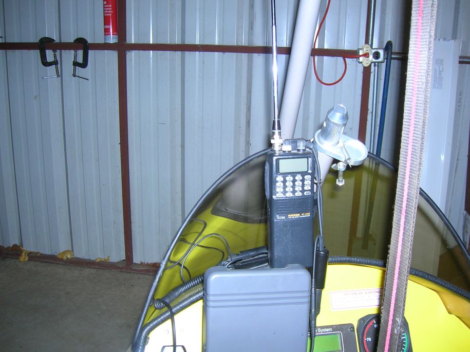

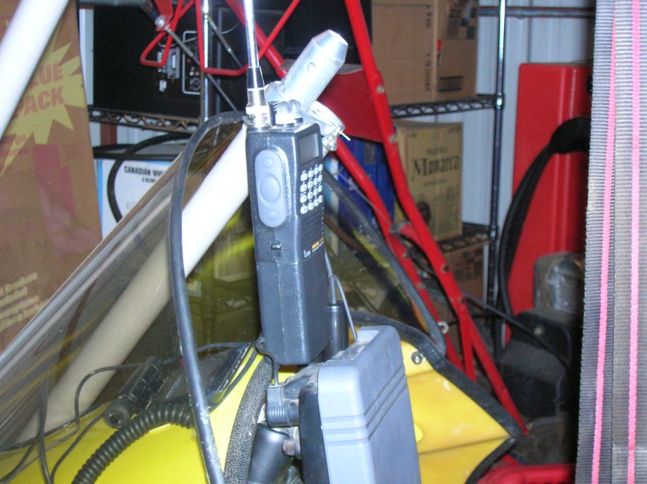

We've been missed by all the big storms again this spring and I count that a long way toward things being pretty good.I'm expanding my mission profile by taking the trike to its first towered airport for the chapter 980 Fly In at IDP this Saturday. Rather than having to call ahead, I added a power tap (21st century cigarette lighter receptacle) to the panel and a bracket from the forward mast to attach the A-22. The radio stands atop the panel and the rubber ducky, or any other antenna for that matter, stands vertically above the wind screen. There's no structure exactly parallel to the antenna, although the forward mast (a 1 1/4" aluminum tube) is about two inches from the antenna base and this distance gradually increases. As I was out in the hangar this evening my eyes fell on a disused telescoping antenna from an ELT. Its BNC connector mates right up to the radio and gives me a "tunable" length. What the heck, the price was certainly right.
Thanks to all who responded. Great help just a few keyboard clicks away.
