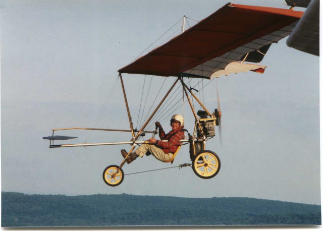

PostPosted: Sun Jun 21, 2009 7:37 am    Post subject: Cayuna 430 and Pterodactyl Reply with quote
Can anyone give me the estimated or actual fuel burn with a Cuyuna 430, and the usual cruise speed for a Pterodactyl the one with the canard in front of it.
Same thing with a Rotax 440 and Eipper MX the single surface old vintage type?
etzimm(at)gmail.com
PostPosted: Sun Jun 21, 2009 10:52 am    Post subject: Cayuna 430 and Pterodactyl Reply with quote
2 gal per hr. (at) 35 / 45 cruise, 55 mph vne.

captainron1(at)cox.net
PostPosted: Sun Jun 21, 2009 2:42 pm    Post subject: Cayuna 430 and Pterodactyl Reply with quote
That's exactly what I need, and from the picture it looks like the bird I am flying has the bungee cords on the wrong end. I have no tach or any instruments yet. I'll be using my G-295 for everything else on a Ram Mount when I need to get somewhere.

PostPosted: Sun Jun 21, 2009 5:33 pm    Post subject: Cayuna 430 and Pterodactyl Reply with quote
front of it.
type?
Ron,
The Dac Ascender with the 430 Cuyuna burns 2 to 2.5 gph max, likes to cruise
from 40 to 50 mph. I sold my old Pterodactyl to a friend that still flies
it with a J-bird supplied 440 Kawasaki and belt drive, he burns about 1.5
gph at 55mph+ but he clipped three feet off each wing.
The MX will burn quite a bit more and go a lot slower.
Denny Rowe
