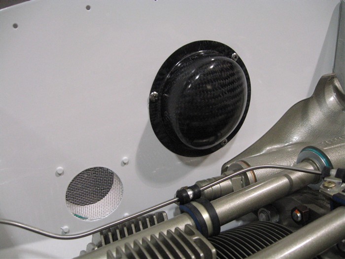

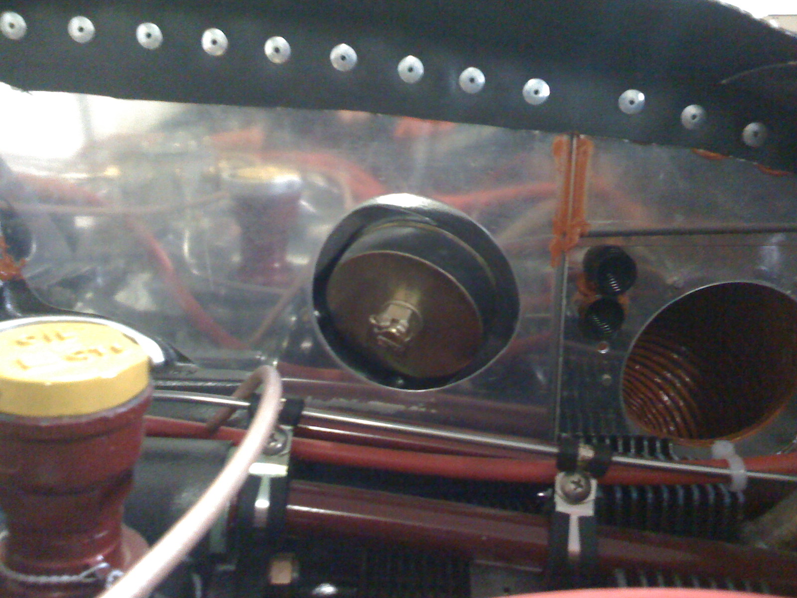

Hi
I was wondering if you sealed the gap between engine mounts and baffling with RTV. Is there another way since the gap seams quite big.
Michael

That is what I did. Held up so far.....~90 hours.

I cut some pieces of baffle material into small patch circles to cover that
area and pop riveted them on.

Michael I made these for my RV-10 and decided that I would offer these to everyone. They are very easy to put on. They require 3 #6 nut plates.
They are real easy to take on and off. Cost is round 70.00 a pair. They are carbon fiber. Here is a link below to my web page for more pictures
in the firewall forward area.
http://albums.phanfare.com/isolated/L5LenCCI/7068012/3161550[/code]
