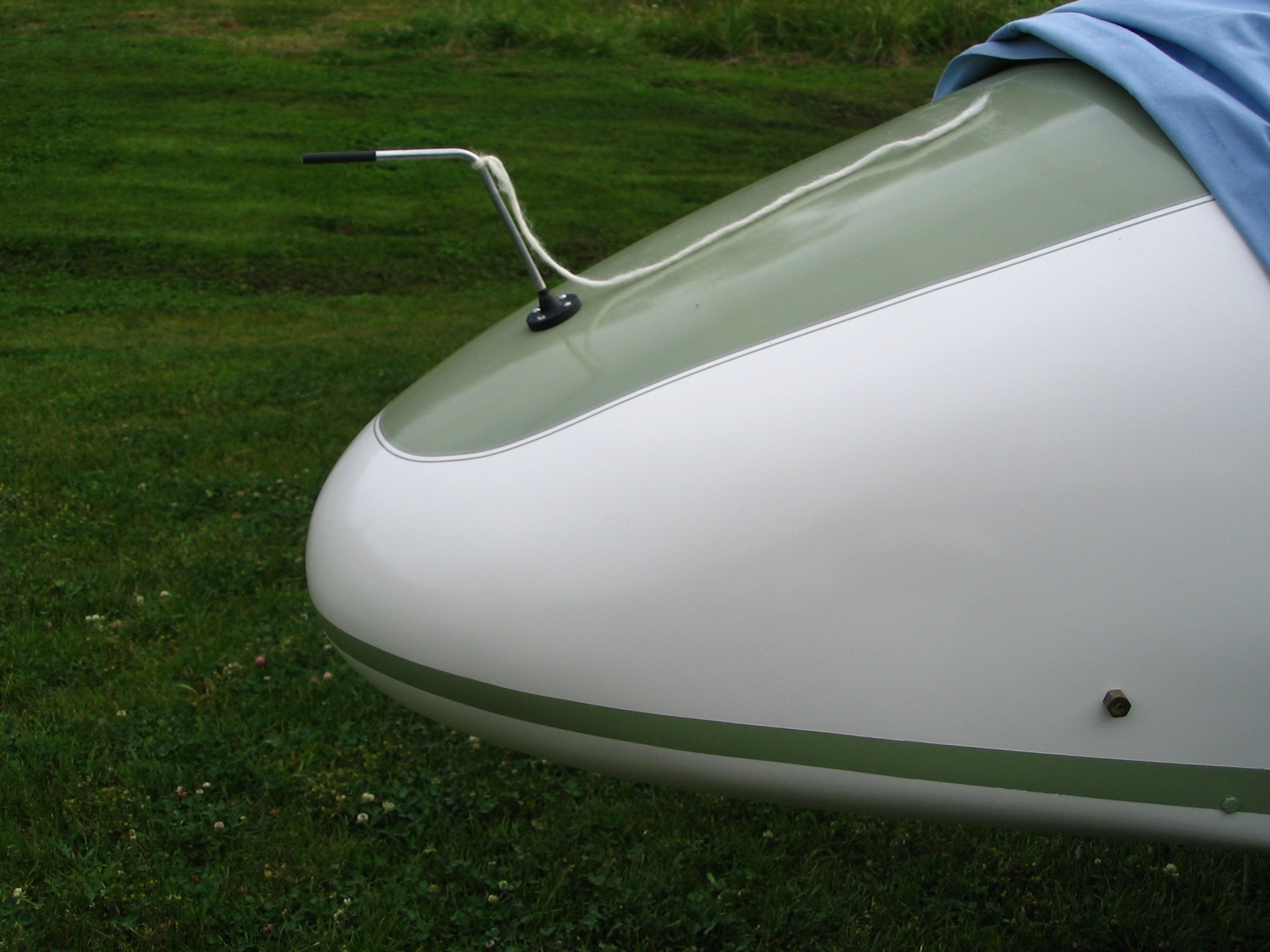

Having wiped off the pitot tube twice from my Xtra by getting into long grass etc I replaced it on top of the nose cone. Just far enough back so that it wouldn`t get wiped off by someone walking by.
Flew last night and found the ASI reading about 10/15mph slow. 2800 rpm produced only about 50 mph instead of around 65. Did a couple of stalls at 2000ft to get some sort of idea and landed OK by guess and by God with the ASI hovering just below 30mph.
Anyone put their pitots in a different position who can guide me to a good spot for refitting?

PostPosted: Mon Jun 15, 2009 7:29 am    Post subject: Re: ASI Reply with quote
I have my pitot on top of the nose and it is accurate (gps checked). If I was doing it again I would try it an inch or so further back as it sometimes gets bent when it's in my crowded hanger.
cheers, Rob Cannon

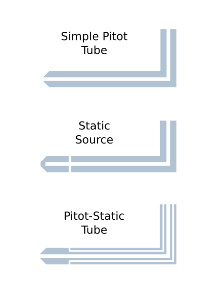

Pat, There's another option you might wish to try that I use on my Mk III and my trike. Both a short section of stiff vinyl tube to connect the short pitot sticking out of the fuselage to an extension that gets it out about 8" into the airstream. If I or someone else hits it it just bends out of the way and then comes back into line when the offending party, usually some cow at a Fly In, removes her haunch. Cheap to try and probably saves you from having to call out the engineering battalion.

Actually, I found a PT-17 pitot/static system when I was building my mkIII, and installed it to the strut using 4 pop rivets.
Ran the tubing through the lift strut.
It is a single tube aproximately 5" long that incorporates both pitot and static pressure systems.

It is a single tube aproximately 5" long that incorporates both pitot and static pressure systems.>.
Thanks John, that sounds pretty neat with only a single tube.I have never heard of that. Does that mean it measures pitot pressure only and you use cockpit static?.

I say again, the single tube incorporates both pitot and static pressure systems. Too complicated for me to try and explain how it is designed before I have my first cup of coffee.

Pat- Aircraft Spruce lists a couple of the single tube designs, plus a couple of the double tube designs.  Listed under "Instruments". Page 394 in my catalog. I don't know which one John has. They list one for under $20 (US), and go up to almost $180.

PostPosted: Wed Jun 17, 2009 5:39 am    Post subject: ASI Reply with quote
Perhaps this drawing would help.

Thanks, Rick.
The single tube pitot/static system at the bottom of the file is a good example.
My system was manufactured by Kollsman Instruments during WWII. It was still in its original wrapping with cosmoline. Has a Federal Stock Number on it. Think I got it from WagAero for about $12.00. Made of nickle plated brass.
