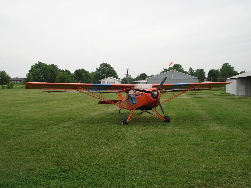

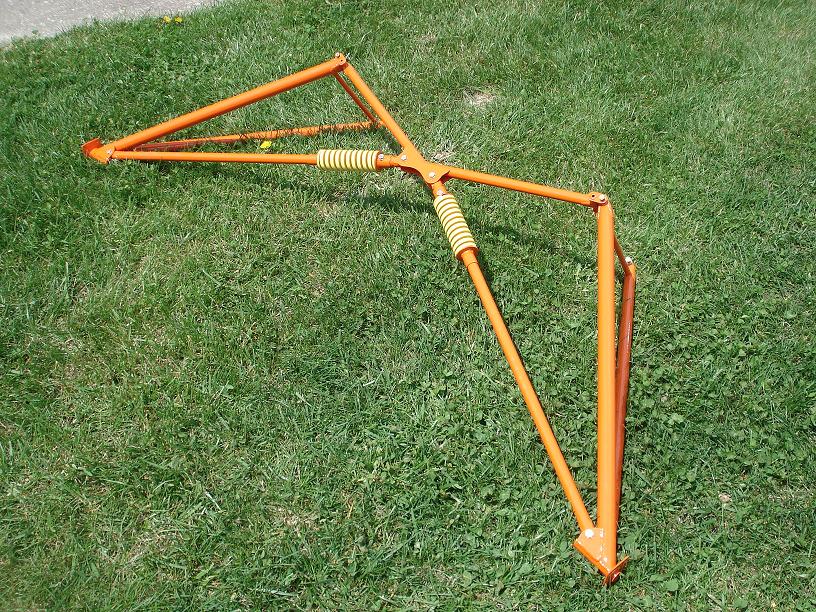

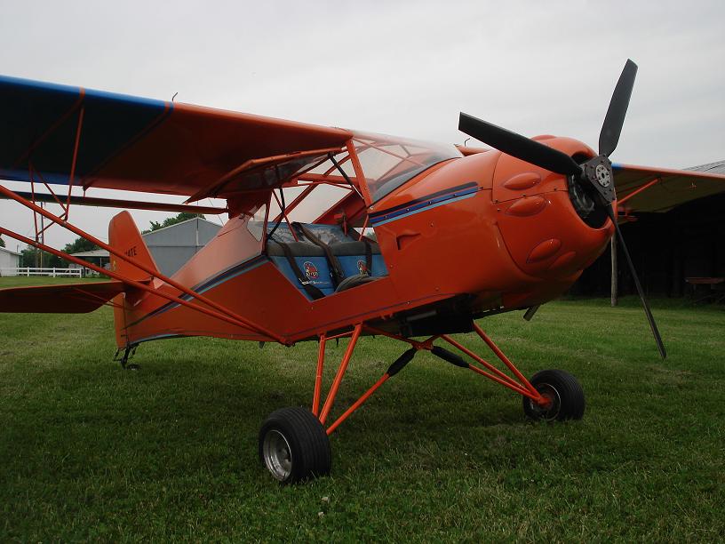

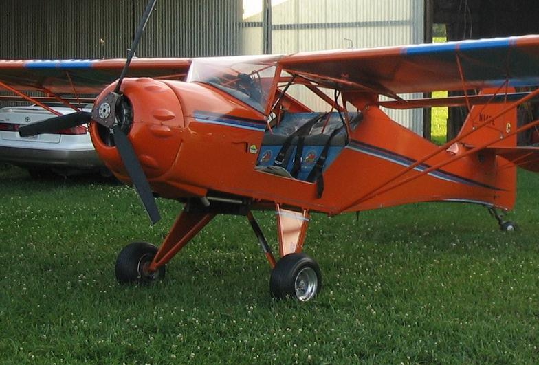

Flew all weekend on the new bush gear, and it is a night and day difference for me. I'm a low time taildragger pilot, so I probably over correct and seem uncoordinated anyway, but with the old gear it seemed like every time I landed it was a great adventure between the time that my gear touched and I stopped. The first time I took off with the bush gear I was on edge about how it was going to act, but wheels touched and the aircraft just tracked straight ahead with no problems. With about a dozen landings now on the gear (even some pretty good crosswinds), I can say I am loving it.
The aircraft weighs about 5 lbs less now, and lost about 4 mph (the old gear had the wood streamlined struts and fabric).
I chose to go with the Highwing LLC gear instead of the Kitfox (McBean) gear for a few reasons. The Kitfox gear comes with a few extras (new axles, white powder coating, etc) but they also have a higher price tag. Since I was trying to reduce cost, it was easier for me to reuse the original axles and wheels and paint them the color I wanted. Lowell and the guys at Highwing completed my order faster than promised, and I was amazed that it all bolted on to my existing mounts without any "persuasion" needed at all.
All in all, I couldn't be more pleased.

I knew that there was some confusion on the weight when Dick posted his update, so I made sure to do a complete weight and balance before and after the swap. The only change between measurements was the gear including the new brakes lines and everything. I'm not sure how much the wood and fabric on the old gear weighed, but I think you could safely say that the gear themselves are pretty equivalent in weight if not lighter than the original.

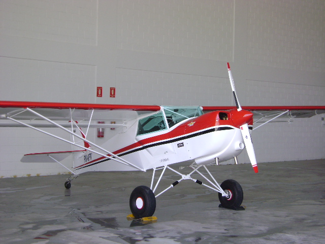

Could you share kitfox´s photos with Bush Gear ?
Here is mine, with outstanding kitfox factory landing gear!!

The Highwing LLC gear itself is about 66" wide. So, if you have 6" wide wheels like mine, it is about 78" outside of tire to outside of tire. That is about 16" wider and a couple inches taller than the original.

I think it was 72" center to center on the tires.

[quote="dcubj3(at)terra.com.br"]Could you share kitfox�s photos with Bush Gear ?
FD
Brazil, SA
www.dcubj3.com.br
[img]cid:0F8567AE445B4CC8BEA991C55694DB5B(at)compa563fded83[/img]
Now that is one sexy looking bird! VERY, VERY NICE!!!

I am glad you enjoy your new gear as much as I do. It absolutely makes this a new airplane in the ground handling department and also adds stability on approach.
It is interesting to note that you too received the same results from the gear as I did. It is lighter in weight than the stock gear and there is an approximate reduction of 3-4 mph in cruise speed. Now perhaps the nay sayers will believe the results I came up with. It looks better too.
My gear span is now 7 ft measured at the outside of each tire.(Nanking) That is a 3 ft increase in gear span.
There is no way I would ever go back to the original gear as the results of the "bush gear" is phenomenal !

I still like mine. Aircraft handles better, and seems more stable. Plus, I got to smile a little when I saw two guys wrapping bungees on an older Merlin GT a couple of weekends ago; Never again (at least on this plane).
Regrets: Only the reduced performance. My aircraft was never a speed demon, and the increased drag has really played with it. Level cruise is only effected by 5 mph, but it also means slower to build speed, and recoup lost airspeed. I'm definitely going to be installing some speed mods to counteract the loss. It will be interesting afterward to see how much of the improved handling characteristics are due to the extra drag.
